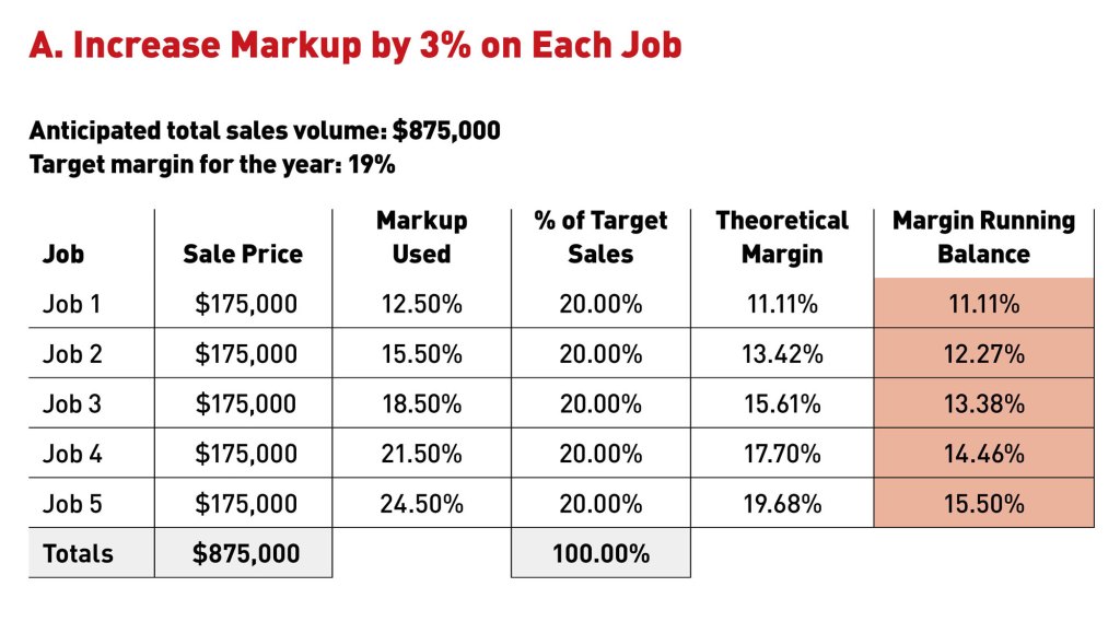

Increase Markup by 3%
In the first example (A), target sales for the year is $875,000; target achieved margin for the year is 19%; and current markup is 12.5%. The strategy here is to increase the markup by 3% on each job sold, irrespective of the size of the job.
For the sake of simplicity, in this first example, all the jobs have the same selling price. That means that if Job 1 has a selling price of $175,000 using a markup of 12.5% and Job 2 has a selling price of $175,000 using a markup of 15.5%, the costs to produce Job 2 are smaller.
Notice that the theoretical margin increases for each job (from 11.11% on the job with the 12.5% markup to 19.68% on the job with the 24.5% markup). Still, the running balance of the margins—15.50%—fails to meet the target—19%—even though the projected sales volume of $875,000 is met.

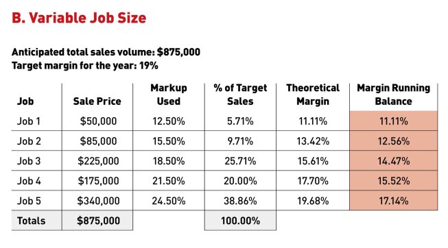

Variable Job size
Let’s see what happens when the same conditions are in effect as in the first example, except the job sizes fluctuate significantly (B). In this instance, because the higher markups were applied to larger jobs, the overall achieved margin—17.14%—is closer to the target 19%.

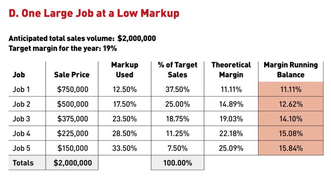

Effect of One Large Job at a Low Markup
This is the same company as in the third example, but see what happens when it sells its largest job of the year at the old markup (12.5%), and the remaining projects that year are smaller (D). This time the company doesn’t come close to meeting its target margin.
