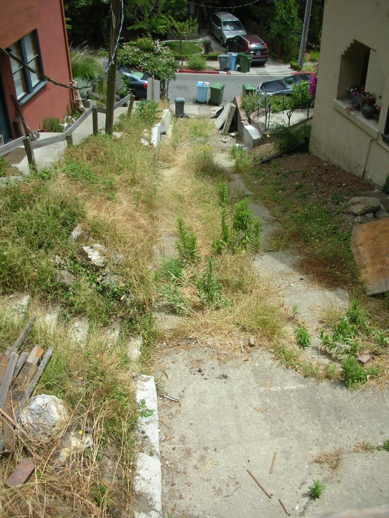

If you were to climb this dilapidated driveway and walk up the stairs that begin at the left side of the photo, you would come to a house surrounded by several level staging areas. The driveway and stairs obviously affect access. But they won’t impact access for all items of work in a renovation of the house; they will do so primarily for set-up and breakdown and (especially) for material delivery. But once the jobsite is set up each day and material is in place and handy for installation, access will be just as it would be on a gently sloping lot. Therefore, when the costs of a renovation are estimated, they need to be modified upward for setup, delivery, and other work that involves climbing the drive and stairs. But they will not need to be modified for the installation of items in the project. Figuring that out is not art; it’s estimating.

A final rationalization holds that estimating is as much an art as it is anything else. One builder advocating for the estimating-as-art idea sought to support it by describing a series of projects with difficult job site access. His examples were helpful. They illustrate how important it is to account for access, especially difficult access, when building an estimate. But to call that process “art” does not seem to me to be helpful; for it implies that an estimator can rely on some sort of loose intuitive process when what is really called for is controlled number crunching. Adjusting for access in an estimate serves to illustrate that point nicely.
Difficult access will slow productivity. But it is equally important to note that while access might be difficult for some items in a project, that does not mean it will be difficult for all items. For example, tight interior space may slow productivity for the tear-out, some reframing, and all finish work in the replacement of a worn-out bathroom that is up a stairway and at the end of a narrow hallway. But it won’t adversely affect floor reframing or repiping or rewiring if that work can be installed from an uncluttered garage under the bathroom. In other words, for some items of work in a project, difficult access will slow productivity, and the costs in an estimate for that work must be appropriately adjusted. For other items, access may be normal and productivity and costs won’t need to be adjusted at all.
In short, adjustments to productivity for difficult access should be made not with some broad brushstroke applied across an entire estimate, but selectively and precisely. If you want to describe the work via metaphor, call it a target sport, not “art”—which, like other rationalizations for loose or even sloppy estimating, can too easily become just a cover-up for the lack of well-honed estimating procedures.

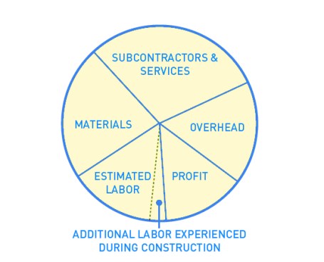

Which Charges to Include? The above chart, which summarizes the charges in an estimate and bid, does not include a slice for equipment. Here’s why: Relatively small items of equipment, such as table saws, are most efficiently charged for as part of general company overhead. Heavy equipment (think front-end loader or excavator) is another matter; its use should be charged only to the projects for which it is used. If it is not to be used for a project, you don’t want to bump up your bid by including costs for the equipment in your estimate for that project. And that is what would happen if its cost were included in your general overhead markup. Bear in mind, a bid that is low is a bad bid. But a bid that is unnecessarily high is also a bad bid. If you win it, it might be a lucky bid. But it still is bad work, for it means you do not have control of your numbers. And over the long haul, that’s going to do your company more harm than good.
Subcontractor costs can be estimated tightly by:
1) requiring that subs cover all work normally produced by their trade unless that work is explicitly excluded in writing and
2) making sure any excluded work is covered elsewhere in the estimate. (As with labor productivity, we will take a look at just how those steps are accomplished in an upcoming article.)
Material costs can be accurately nailed down with thorough quantity takeoffs and written—always written—quotes from reliable suppliers and contract protections against inflation.
Overhead costs can be reliably allocated to projects one job at a time. In my view, that is best accomplished by allocating overhead for a project on the basis of the length of time that project will take and the portion of company capacity it will absorb—that is, by using the “time/capacity method” I detail in Nail Your Numbers. I am not a fan of the much more commonly used fixed percentage or gross profit margin (GPM) methods. The first is simplistic. The second is unnecessarily complicated and muddies the distinction between overhead and profit by marking up for them with a single calculation.
Profit for a job can likewise be projected reliably. True, figuring the amount of profit to include in a bid is a judgment call that takes into account a range of factors including market conditions. But the amount of profit that will remain in a builder’s bank account when a project is completed will be as anticipated if the other costs in a job are figured accurately, and if the job has been properly qualified for a bid, is built under a thorough and fair contract, is well run—and is not hit by one of those strokes of bad luck that do plague the construction business.
Labor is the toughest of all project costs to figure reliably. But that, too, can be done. Building a file of labor productivity records is the critical thing.
The final good news about the items in the pie chart above is this: Even a fairly large miss in estimating labor costs results in only a minor miss in your overall bid. You might be low on your labor estimate by 15%. But if labor is, say, one fifth of the total price for a job, then your miss on the labor will cause your total price for the job to run off by only some three percent (.2 x 15% = 3%). Further good news: Over time the small misses in labor cost estimates, some low and some high, will tend to balance one another out.
If you are willing to do the work necessary to build a strong estimating system, errors in your estimates and bids as a whole will also tend to balance out. As the estimating manual of the Associated General Contractors points out, the law of averages is on your side. You may never quite hit the bullseye dead center with any given estimate and bid. Perfection in estimating is no more attainable than in any other target sport. You will miss a bit one way on one job, somewhat in another direction the next. But over time the misses will average out to close to zero, and your overall results will get closer to the center of the bullseye.
