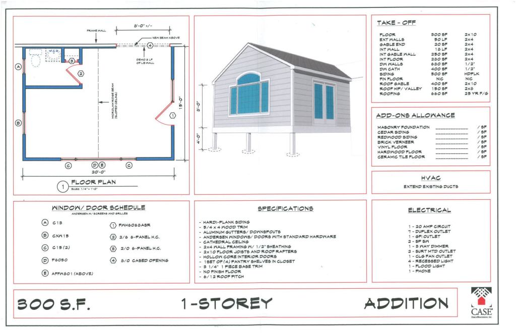

The second step is to take time to think through your typical project and standard specs. I recommend making a basic sketch for each template that includes dimensions, take-offs, specs, and notes. There’s no need to go into great detail here because no two projects will ever be exactly the same. But having all of this information on paper will make it easier to put together the templates, as well as give you a reference for that time down the road when something changes and you ask yourself, “How the heck did I come up with this in the first place?”
The last step—and it’s a big one if you have a long list of projects—is to do estimates for small, medium, and large versions of each type of project on your list. For each project type, start with the “large” template and perform a complete estimate. You should include every line item—with the correct quantities—needed to build the project in its entirety, from start to finish.
