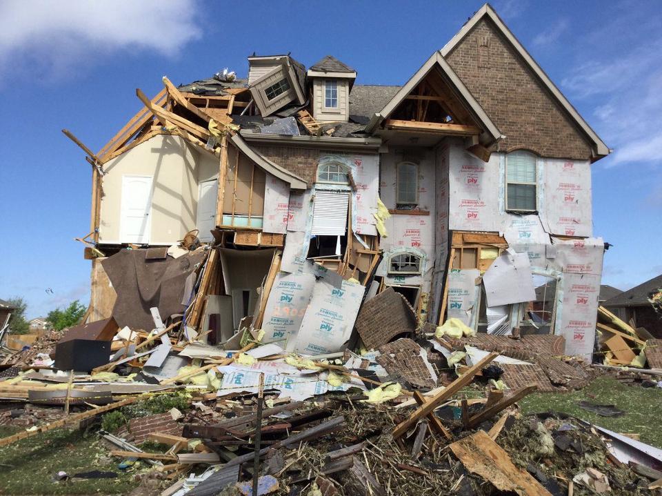

It doesn't take a tornado to destroy a house ... depending on how the building is constructed. Several houses in the Dallas, Texas, suburb of Rockwall were ruined last week by 95-mile-an-hour straight-line winds, according to press reports and the National Weather Service (see photo, below). Forbes magazine blogger Dennis Mersereau jumped on the story (see: "This Destroyed House Proves A Severe Thunderstorm Is Just As Dangerous As A Tornado," by Dennis Mersereau). "Wednesday's storm damage in Texas should be a wake-up call that we should treat the threat of damaging winds just as seriously as a tornado," commented weather buff Mersereau. "You don't know how well your house will stand up to intense winds until they happen, and by then it's too late to run for cover if your home isn't as strong as you thought it was."
Lower-story walls in this home lacked the shear capacity to withstand straight-line winds estimated at 90 to 95 mph.
The "Texas Sky Ranger" helicopter from TV station NBC 5 in Dallas viewed the wreckage from above (see video here and still photos here). As video and photos from the scene document, the destroyed homes had wood structural-panel roof sheathing. But the building walls were sheathed with a foil-faced sheathing panels, not wood. Photos from the scene show how lower-story walls of one two-story house have racked in response to the wind pressure, and brick veneer cladding has fallen off onto the ground. Adjacent one-story houses show less obvious wall damage—but unfortunately suffered major loss of roofing and roof sheathing, and in at least one case, complete destruction of the roof framing as well.

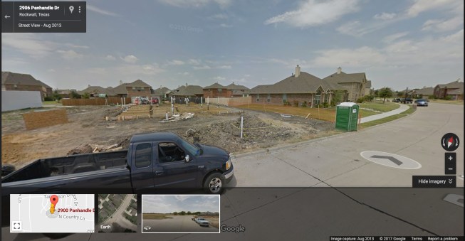

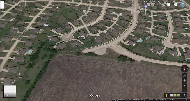

The destroyed homes were built around 2013. A Google StreetView capture of the location, taken in 2013, shows sitework underway at the lot where the homes are sited (below). Zooming out into Google Earth view reveals a satellite image, taken more recently, with a view of the context: the destroyed buildings sat at the end of a street next to an open field, where a long "fetch" for thunderstorm winds would have allowed the wind to build up force. Homes away from the field were likely sheltered by the rough surface created by surrounding structures, and did not experience quite the same destructive wind power.
Sitework underway at the address of a home destroyed by March winds in Rockwall, Texas.
A recent Google Earth view of the homes on Panhandle Drive in Rockwall, Texas, before they were totaled by 95-mph winds. A large field to the south of the location would have provided no protection from the full force of the winds.

After investigating the Garland and Rowlett tornado path, engineers from APA - The Engineered Wood Association posted a formal "Texas Tornado Damage Assessment Report" at the apawood.org website. Among the recommendations: "Continuously sheath all walls with wood structural panels including areas above and below openings, such as windows and doors."
