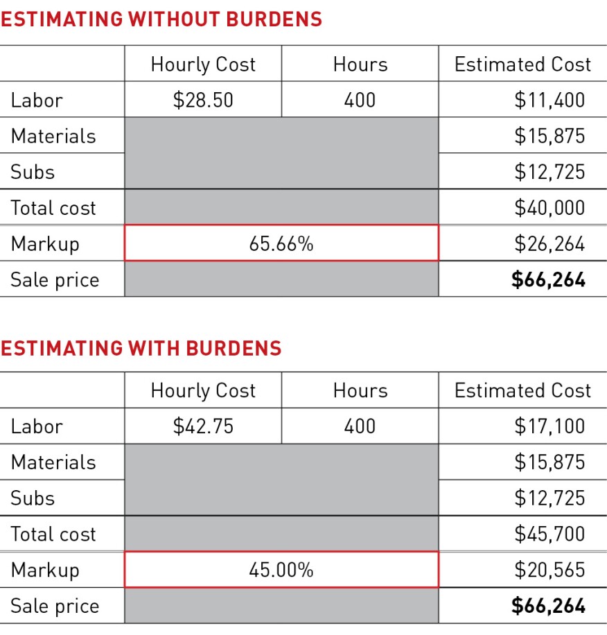

The impact of these burdens on financial and job-costing reports can be significant. Basically, the more generous and numerous the burdens, the larger the gap between the base hourly wage and the burdened cost per hour. When working through labor burden calculations with clients, I often see examples such as $28.50/hour for wages and $42.75/hour for burdened figures. This translates to a 50% cost increase due to burdens.

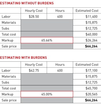

If you estimate without a fully burdened labor cost (top), you may be able to make up for it with a higher markup to price the job accurately. Note the difference in estimated costs (bottom).
There are multiple implications associated with not knowing your fully burdened costs, which I will cover in this article.
Estimating
If you estimate using a partially burdened cost for your labor, you risk underpricing the job. It’s that simple.
Some companies address this risk by putting only wages above the line and putting all burdens in overhead. This inflates overhead, and provided that they base their markup on a formula consisting of overhead and achieved margin (see charts “Estimating Without Burdens” and “Estimating With Burdens,” left), they may succeed in pricing the job correctly. Their markup will simply be higher than that of a company putting burdens above the line, but based on a lower estimated cost. The job price can be the same, but there will still be issues when it comes time to job cost and calculate work-in-progress (WIP) adjustments.

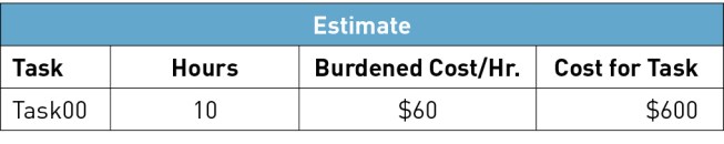

Focusing on a single task, “Task00,” let’s see how this plays out: Say you have calculated your burdened hourly rate at $60. Your estimate allows 10 hours to complete this task. Therefore, the estimated cost to complete Task00 is $600 (below).

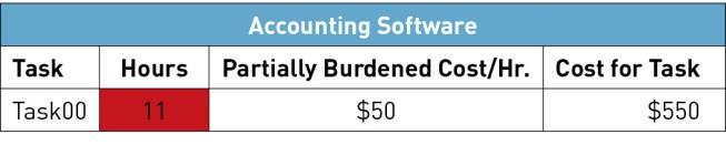

However, if your software includes only partial burden, it may display an hourly cost of $50, not $60. When you review your job cost report, you note that Task00 “cost” $550. Since the estimated amount was $600, it appears that you are $50 under budget.
But wait! Task00 actually took 11, not 10, hours. Because the software applied only a partially burdened labor cost, it calculated a deceptively low cost of $550 (11 x $50) for the task (above). At the fully burdened cost of $60/hour, however, the actual cost for the task was $660 (11 x $60) and you’re over budget by $60 (below).
Obviously, this discrepancy will inflate as the size of the job or proportion of labor within the job increases.
Such reporting errors can lead to unfortunate results, such as bonusing or profit-sharing on a job that is less profitable than it appears. It can also cause estimators to think they are overestimating the length of time it takes for a task to be completed, which can lead to underestimating and underpricing the next job.

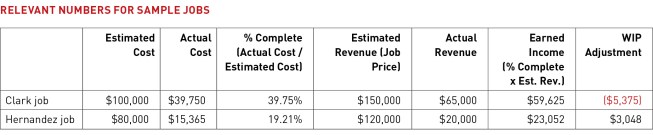

Clark job. Estimated costs for the Clark job are $100,000. The job was sold at a 50% markup for $150,000. The job costs to date are $39,750, and the invoices to date total $65,000.
Hernandez job. Estimated costs for the Hernandez job are $80,000. This job was sold at a 50% markup for $120,000. The job costs to date are $15,365, and the invoices to date are $20,000.
As of the first reporting period, the chart below shows the relevant figures for each job.
In the case of the Clark job, the customer has been overinvoiced (revenue—what has been invoiced—in excess of earned income) and the WIP adjustment is a negative number. In the Hernandez job, the customer has been underinvoiced (earned income in excess of revenue) and the WIP adjustment is a positive number.

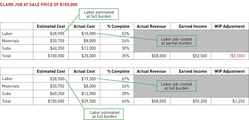

The “Estimated Cost” of labor in both charts above includes full burden. In the top chart, however, labor is job costed with partial burden (apples to oranges), which throws off “Earned Income” and results in a negative WIP adjustment. In the lower chart, labor is job costed with full burden (apples to apples), resulting in a higher amount of earned income and a positive WIP adjustment.
So what happens if you aren’t using a burdened figure? If your actual labor cost is understated (without burdens, as shown in the top chart, above), then “% Complete” will be inaccurate. Since your earned income figure is based on that percentage, your earned income figure will be incorrect. Since your WIP adjustment is based on the discrepancy between reported income on the P&L and earned income from your WIP calculator, your WIP adjustment will be wrong.
