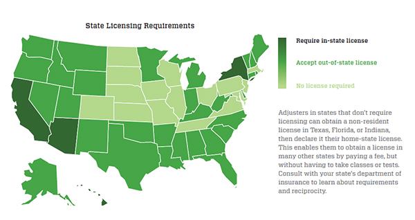

Licensing. To become an independent catastrophe, or “CAT,” adjuster, you have to obtain a license. Check with your home state’s department of insurance to find out what the requirements are (see map, page 52). You would begin by applying for an “all lines” or casualty and property adjuster’s license in your own state. Some states, such as my home state of Colorado, don’t require a license, but without one, nobody takes you seriously.
Licenses from Texas, Florida, and Indiana are among those that enjoy the highest level of reciprocity. Having one will allow you to obtain a license in most other states just by paying the fee—no tests or classes required. (The exceptions are Arizona, California, Hawaii, and New York, which require separate licensing.)
If your state does not require a license, you can obtain a nonresident license in Texas, Florida, or Indiana and designate it as your “home state” license to enjoy most of the benefits of reciprocity. Texas offers the greatest number of approved adjuster license courses, many of which are online. Its license is the most widely recognized in the industry, so it’s generally the one recommended for those starting out.
Another reason to get a home-state license is that insurance companies prefer to deploy adjusters already licensed within the disaster area in the first wave, before a state of emergency is declared. And they often employ locally licensed adjusters to stay afterward to handle any additional damage discovered after the initial claim. That said, states often waive their license requirements in a state of emergency, granting temporary emergency licenses to out-of-state adjusters.
For a license, you’ll need to complete the 40 hours of required training, pass a test, and submit your application to the regulating authority. For Texas and Florida, this entails fingerprinting and a criminal background check. Usually you will receive your license within a few weeks. Indiana currently does not require fingerprinting, and its process takes less than one week.
Once you have a home-state license, it’s a good idea to get licensed in areas where big storms occur, such as along the Atlantic coast, or in underserved areas where few independent adjusters have licenses, such as Arizona. In every instance, you’ll need to take continuing education classes to maintain your primary license.

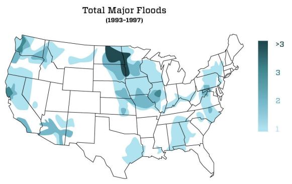

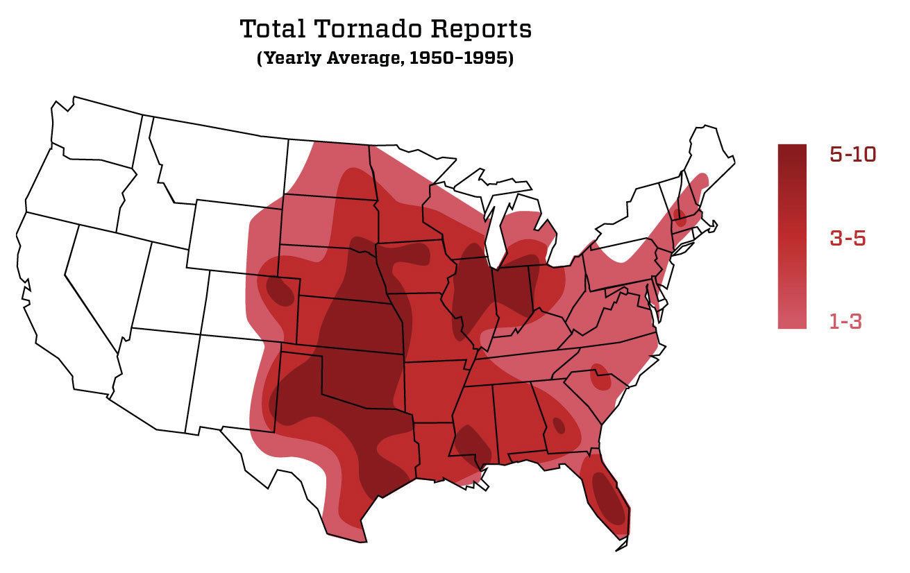

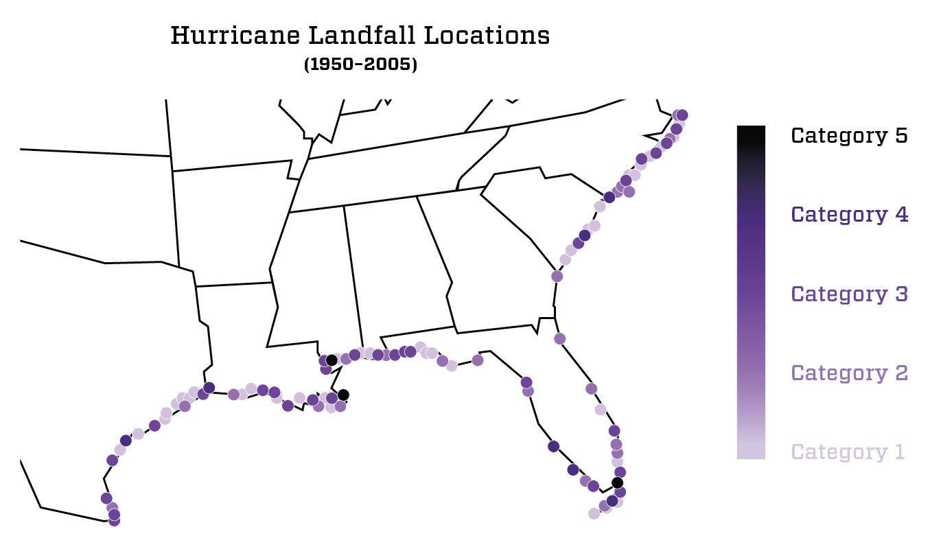

Insurance adjustment work is unpredictable. It comes and goes with the weather, and it fluctuates year to year. When a huge hurricane makes landfall or several storms hit back-to-back, it’s easy to get hired. Otherwise, you may get licensed and trained, then wait two years for your first deployment. But in my opinion, it’s still worth it: In a banner year, top-level adjusters can earn $200,000 or more.
A few major adjusting firms, such as the four mentioned above, and many small ones as well, keep a stable of qualified adjusters eligible and ready to deploy in the event of a catastrophe. Every year, tropical storms, hail storms, tornadoes, and floods provide deployment opportunities. Whether you sign up with one large company or several, the goal is to generate a steady stream of deployment requests that you can accept or decline at your discretion.
Certifications. Disasters occur everywhere, and your adjuster’s licenses allow you to adjust most claims, from hail to hurricanes. But some claims require specialized certification. I worked flood claims during Superstorm Sandy and found the niche rewarding. It is paperwork intensive because most flood insurance is underwritten by the Federal Emergency Management Agency (FEMA), but the pay is about a third more for the same dollar value. The claims process is also cut and dried because there’s only one policy to learn, unlike in the general insurance market, which has a dozen or more polices to deal with.

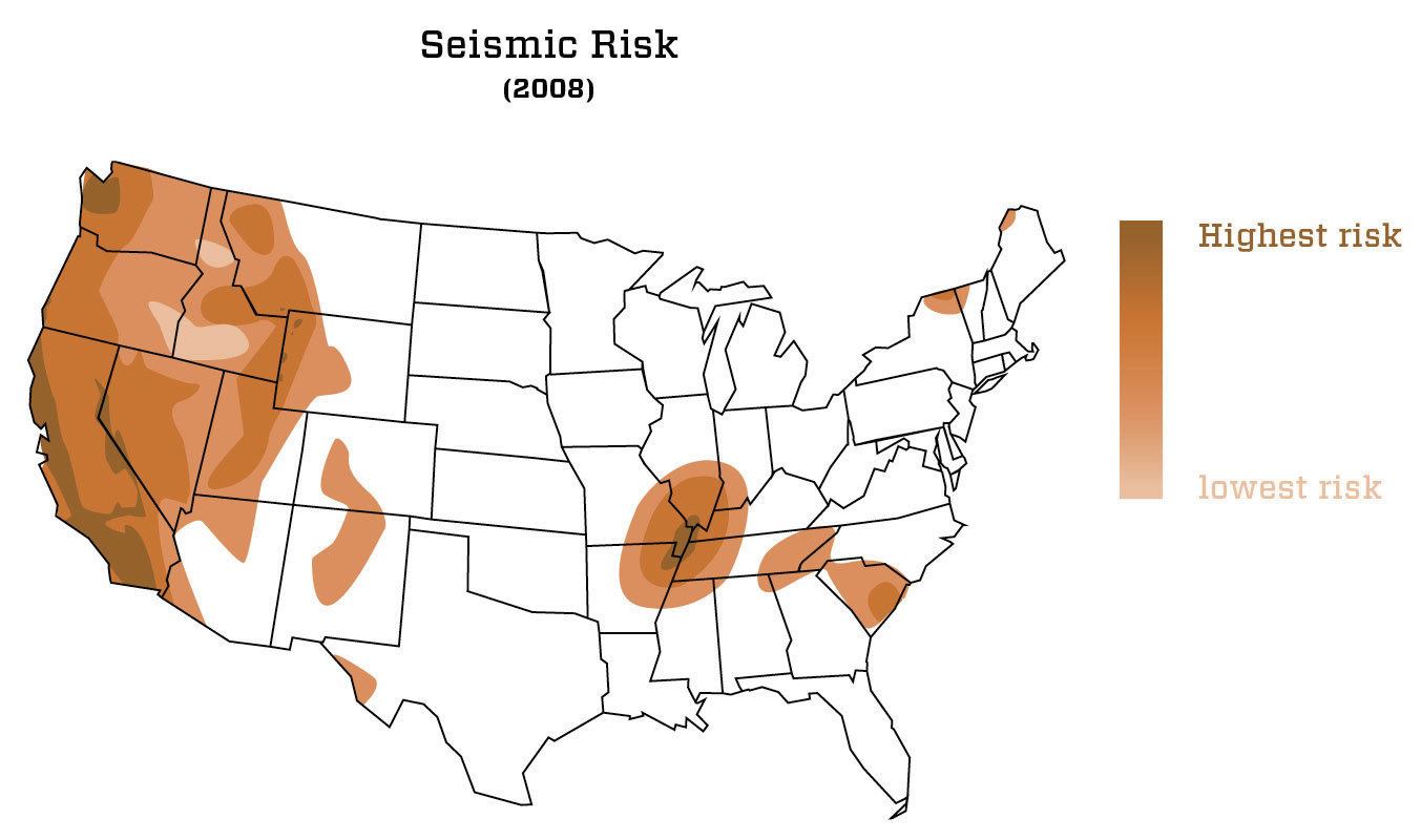

The other certification to consider is for earthquake claims in California. They don’t come often, but when large earthquakes do occur, there’s a lot of work to be done.
