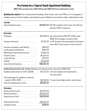

This pro forma is based on the four-plex shown above, which the author built on the site of an old house he held for five years while paying down the lot. The building sold in 2008 during the height of the real-estate crisis for the full asking price.
