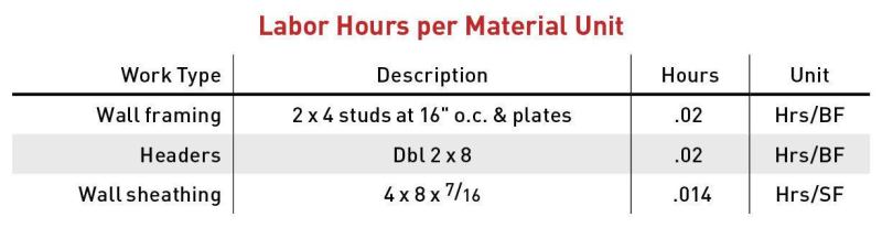

To use your own data to find hrs/BF or hrs/SF, divide average hours used for each framing task by total SF or BF of materials used. (BF = thickness x width [in inches] x length [in feet] ÷ 12). This table shows figures for tasks associated with framing and sheathing a typical exterior wall.

Whether you use published cost data or your own records, here’s a method that applies a unit of time to the material quantities used—the table (top) shows how it applies to our 20-foot wall example. Published cost data usually provides labor in terms of hours per board-foot (hrs/BF) and hours per square-foot (hrs/SF). To convert your own labor data to these units, add together all of the framing labor on all of the jobs for which you’ve been keeping records—the more data, the better—then divide the total by board feet of lumber and square feet of sheathing used on all of those jobs. This will give you hrs/BF or hrs/SF to plug into the “Hours” column.
The bottom table shows how to find total labor to frame our 20-foot wall by multiplying BF and SF of material times hrs/BF and hrs/SF. Board feet equals thickness x width (in inches) x length (in feet) ÷ by 12. (For example, an 8-foot 2×4 contains 5.33 BF — (2x4x8) ÷ 12). “Total Hours” (6.64) would be plugged into the labor section of the “Item or Task Worksheet” (Aug/13) and multiplied by the hourly crew cost to arrive at the cost of framing labor.
