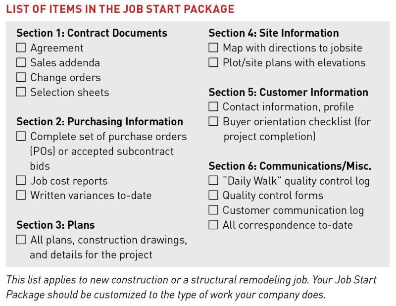

This list applies to new construction or a structural remodeling job. Your Job Start Package should be customized to the type of work your company does.

At a small-volume company, the process involves a meeting between the lead carpenter or project manager together with the designer and estimator (and sometimes the salesperson) to compare the “job start package” (see sample list, below) with the final direct cost estimate and preliminary schedule. If issues are discovered during the review, the project manager can then adjust the schedule (within reason), modify estimates and trade agreements (before they’re signed), and fine-tune anything affected by these changes.
Don’t confuse the job start review with a “pre-construction” meeting where the customer is present. Both are important communication tools that help to put everyone on the same page, but the job start review gets deep into the nuts and bolts of the job at a level of detail that most contractors wouldn’t want their customers involved with. (For example, a historically accurate addition may require spending more on high-quality subs to save money and headaches over the long run, while a pole barn may just need “fast and loud.”)
The project manager or lead carpenter should review the job start package at least 24 hours before the job start review is to take place, and note any changes or questions that need to be addressed with the rest of the team. Any issues discovered should be resolved during the job start review meeting, and new, clean copies of the modified items made available to everyone. Retain the originals, but make sure that there is only one version active at any given time.

Documenting the Job Start Review
Whether you use one of the several construction-specific services (such as BuilderTrend or Co-construct) or build your own with generic services such as Dropbox or Evernote, the Internet provides an easy way to keep members of your team supplied with up-to-date documents, as well as a place to store updated versions for use during construction. Next time we’ll look at how you can use the “cloud” to collaborate on and document your job starts package.
Joe Stoddard consults with contractors about business systems.[email protected].
Download the detailed Job Start Package here .
