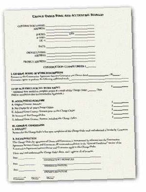

A good change-order form includes an account summary showing the impact of the change — and of all previous changes — on the project's total cost and schedule.

A good change-order form does more than authorize the extra work — it updates the owner and your company on how the change will affect the project budget and timetable. Nothing shakes a homeowner’s confidence — or your bottom line — quite like not knowing the project’s current total cost, including change orders. That’s why I strongly recommend that contractors have a place to record this information on their standard change-order form.
For example, the form at left includes an accounting summary showing how this and all previous change orders have affected the project’s bottom line and project schedule. It provides places to record the original contract amount, the total amount of all change orders to date, and the adjusted gross contract amount after all change orders are tallied. When filling out the form, you should combine profit and overhead with the direct costs to show just one total price for each change order. If a change order has more than one item of extra work, show a total price for each line item.
Including such an accounting summary ensures that you and the owners always know how much work is currently under contract, as well as how much the bottom line has been adjusted up or down over the course of the project. Keeping this information current will save you time, money, and aggravation. It will also make you look more professional. The owners will have greater confidence in your ability to run the project when they see that you pay attention to basic accounting, and that you properly — and fairly — execute change orders before doing the work.
I recommend that each change order indicate the time that will be required to complete it. If you fail to include the extra time on the form, the owners may think you’re behind when you’re actually right on schedule. Adjusting contract-completion dates with each change order will alleviate this problem and reduce your legal and financial liability.
