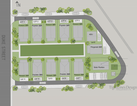

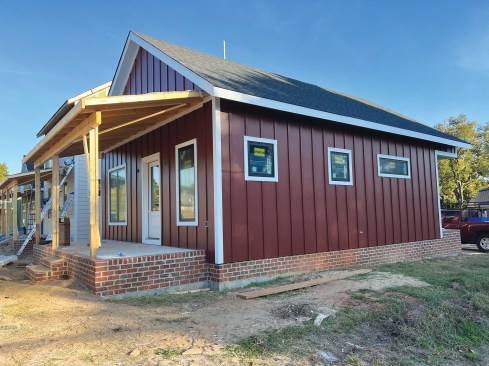

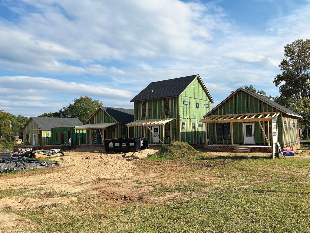

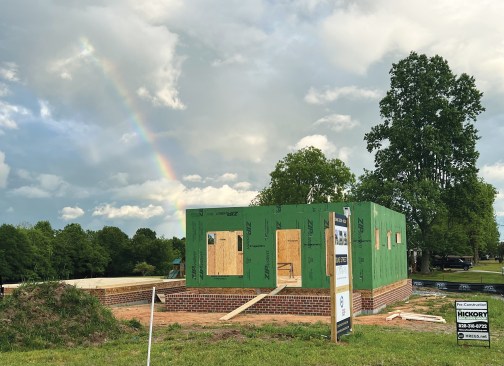

Rob Howard’s first development project was Duke Street Cottages, a “pocket neighborhood” of 11 high-performance, affordable homes in Granite Falls, N.C. Howard has been a general contractor since 2001, and his company, Howard Building Science, completed the state’s first Zero Energy Ready Home in 2015. He has also served as a local director of construction for Habitat for Humanity. The project seemed a perfect fit.
But while building the homes has been straightforward, Howard’s on-the-job training as a developer has included some surprises. Water service, for instance. “I had no concept of how much it would cost,” he says. He had budgeted $50,000 to bring water to each home, but the estimates from county-recommended utility contractors ranged from $75,000 to $105,000. It was looking like a deal killer.
Rather than giving up, he started making calls, including to the building inspector. “I asked if I could use a plumber rather than a utility contractor,” he recalls. “The inspector said yes, but he had to inspect it.” Howard eventually found a plumber who agreed to do it for $45,000 per home.
Detours like this are typical of those faced by builders or remodelers taking a first step into development. In fact, this step is more of an entrepreneurial leap. Development can be financially and personally rewarding, but it’s also complex and risky with lots of opportunities to go broke.
If you’re contemplating this leap, you should start with plenty of research and networking. The basics of land development are too complex for a short magazine article to cover in any depth, but there’s no shortage of educational resources available, from Meetup groups to online and in-person courses. Take advantage of them.
To get permits for the close spacing of homes, Duke Street Cottages in Granite Falls, N.C., was required to have a certain amount of common area. Builder/developer Rob Howard accomplished this with a courtyard in the middle of the property.

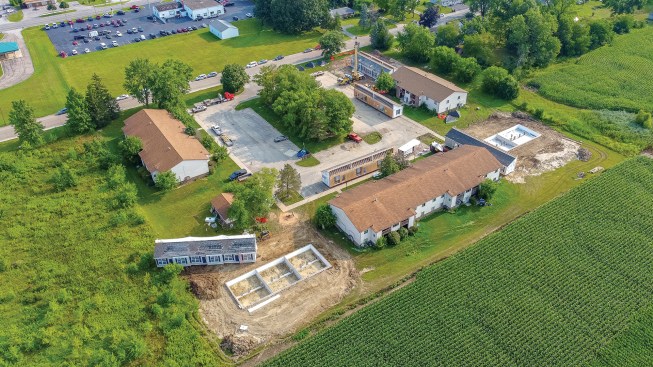

First-time developer Joel Florek of LaPorte, Ind., had enough experience to do this himself. Florek had built a rental portfolio of 150 units by remodeling and rehabbing multifamily properties. Then in 2023, he decided to purchase land and build eight town houses.
The problem was that no project like this had been built for decades. “If you’re building something that hasn’t been done in a long time, you can have terrible comps,” he says. So, he looked at towns of similar size and demographics to develop his own comps, a process that was more art than science. It worked. “We got better results on some units than others, but overall, we have had strong returns,” he says.

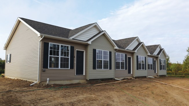

To streamline permitting, Joel Florek chose lots at the edges of an existing apartment complex.
Joel Florek
Town homes were new for the town, which made it challenging to forecast return on investment, but Florek found good comps in other towns with similar demographics.
Joel Florek

The site plan itself needs to be done by a civil engineer, who will consider constraints like setbacks, easements, buffers, and road widths. It’s a good idea to have the engineer sketch out a preliminary site plan and run it past the appropriate people in the zoning department before going further.
“You need to see if you can fit what you want on the property,” says Dan Shabeldeen, of Shabeldeen Engineering in Hickory, N.C., who works with Howard. If the profit goals require 10 homes but the topography or zoning will support only eight, that parcel won’t work. It’s best to know before you buy.
When Howard is serious about a piece of land, he and Shabeldeen walk it together. “We talk about the topography. Is there anything I’m not seeing? How will roads connect to the adjacent community? Are sidewalks needed? Where is the water and sewer access?”

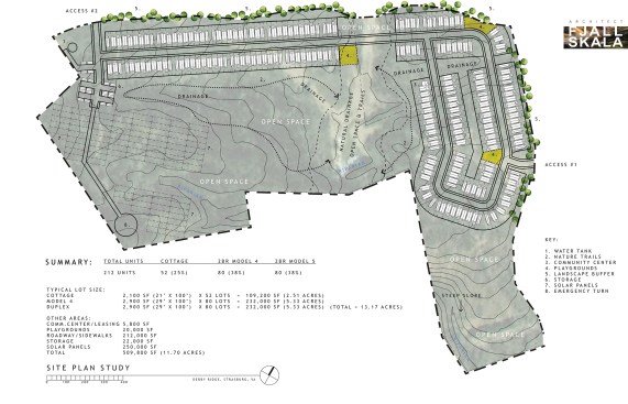

Taking it to the next level: Derby Ridge in Strasburg, Va., consists of 212 small homes that meet Zero Energy standards. The common area includes walking trails, parks, and an on-site solar farm (the grid at the bottom left).
