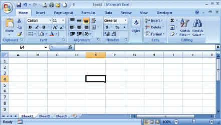

Odds are your computer came loaded with Microsoft Excel, a spreadsheet program that has a variety of tools you can use to track or analyze information about your business. One of these is the powerful, yet easy-to-use, AutoFilter. With it, you can check the overall status of the year’s finances or zoom in on one particular aspect. In this article, I’ll show you how to use AutoFilter to manage a list of purchase receipts and customer charges.
If you’ve never used Excel, here’s the gist: Starting Excel opens what’s called a “worksheet,” which is a huge grid of rows and columns. Each row is numbered and each column has a letter assigned to it. The intersection of a row and a column is called a “cell.” A single worksheet contains millions of cells, so you’re not likely to run out of space.
Worksheets are customizable. As you build a worksheet, you put a piece of information — typically a number or a note — in each cell. You can also set up a worksheet so that Excel performs mathematical operations like addition, subtraction, multiplication, or division on selected cells, rows, or columns. The goal is to organize all the pieces of information and let Excel perform the calculations. Then you can easily see how well (or not) your business is doing.
Please note that the Excel screens shown in this article depict the most recent version of the program, Excel 2007, but if you have Excel 2003, you don’t need to upgrade. The main difference — in the context of this article — is that the “toolbar” of earlier versions of Excel has been replaced by what’s called a “home ribbon” in Excel 2007. It doesn’t change the way that the worksheet functions.

Rows and columns intersect at cells; the cell selected in this worksheet, at the intersection of column E and row 4, is called E4. Excel can be set to perform mathematical operations to selected cells, rows, or columns, providing a variety of ways to look at data.
