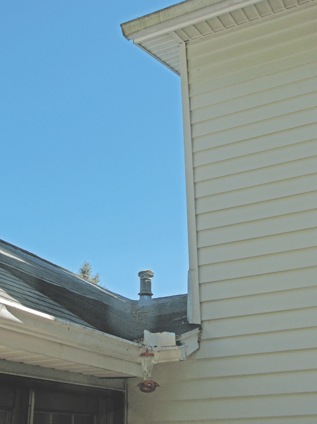

An addition attached to the side of a two-story Colonial created a poorly draining valley, destined to leak. The plumbing vent located in the valley doesn't help.
Clayton DeKorne

A soffit that dead-ends into a roof is guaranteed to eventually lead to a callback. A valley like the one above is a callback (or three) waiting to happen. But not all callbacks are so easy to predict. Some require scheduling work and may even become a nuisance. But even these situations provide an opportunity to win a referral for relatively low investment, Criner says.

Criner also recognizes that some details are doomed to failure. “A soffit or valley that dead-ends on a roof will eventually leak no matter what,” he explains. “The main thing for us is to make sure we don’t design these into a project when trying in an addition roof.”

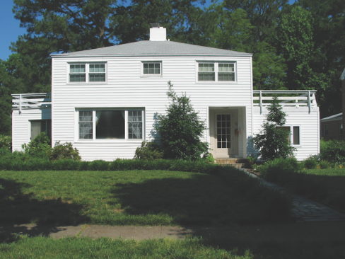

A simple roof or siding replacement on this Virginia home would have been temporary at best. The lack of overhangs presents a callback waiting to happen.
Robert Criner

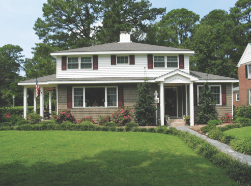

The lack of overhangs on this Virginia home screamed of a callback waiting to happen. But it proved to be a golden opportunity for Criner Construction to upsell a complete exterior makeover.
Robert Criner
