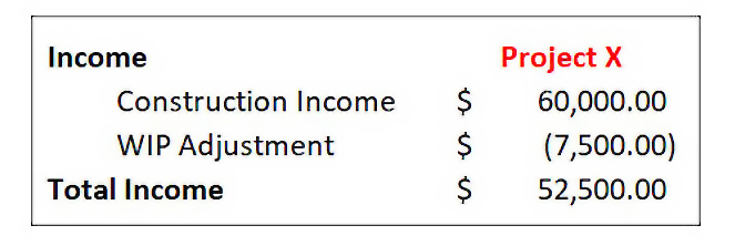

METHOD 4: FIXED PRICE WITH PAYMENT SCHEDULE (WITH WIP)
This method is exactly the same as Method 3, described above, but on a regular, periodic basis (typically monthly), a WIP (Work In Progress) calculation is made and financials are adjusted based on the results.
WIP is based on the Matching Principle (defined in Method 2, above). Revisiting the example used in Method 2, if the project budget is $100,000, and it was sold at a 50% markup for $150,000, then if you have spent $35,000 in costs (and remain on budget), the project is considered 35% complete, and you have earned 35% of the job sale price ($52,500). But if you have front-loaded your payment schedule (which is advisable in terms of cash flow), and you have actually invoiced $60,000 instead of the earned $52,500, then you have overstated your income for that period and must make a correction. This is called the WIP adjustment. In this example, if you look at the P&L for that job for that period, you will see $60,000 in income. But you should see only $52,500. Therefore, you will need to subtract $7,500 from that job’s income. It is best to create a new income account called WIP Adjustment and make the adjustment there. The result might look something like this:
WIP adjustment account on P&L Statement
Depending on where each project is (start, middle, end), how the payment schedule has been set up, and the nature and extent of cost deviations from budget, the WIP adjustments might be either positive or negative.
Pros: If the contractor is already doing fixed price with payment schedule, this method only requires him/her to add the WIP adjustment step to increase the accuracy of the financials.
Cons: Everything said in the methods above with regard to the importance of accurate job costing (especially cost overruns) applies here. If you don’t have a good handle on job costing, don’t even try this, as the results will create more problems. It’s one thing to have numbers that you know are accurate (the number of dollars invoiced in a given period) but misleading (they aren’t all earned), and it’s quite another to “improve” things by making adjustments that are wrong.

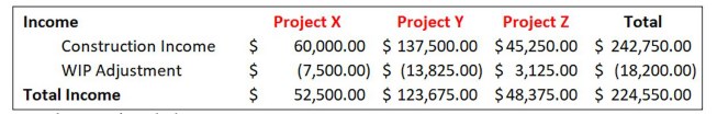

WIP Adjustments for multiple projects
Because WIP adjustments are reversed each month, income on financial reports will be correct only 12 days out of the year—one day each month when you’re making WIP adjustments.
Unless you keep a separate spreadsheet for tracking which customers are overbilled (you have invoiced more than what the job has earned) or under-billed (you haven’t invoiced enough to cover the costs that have been incurred, which really means you’re financing the customer’s job), it can be challenging to know where each customer stands.
