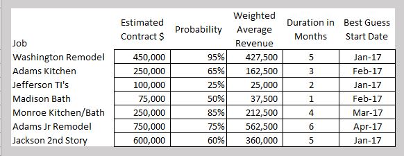

One way to forecast revenue is to create a weighted average spreadsheet, shown in Table 1 below.
First, list all the jobs that may be starting in the next six months. Assign a probability for each job based on how confident you are about the final price and start date. Then you can create a weighted average revenue (WAR) by multiplying the estimated contract by the probability. Finally, guess as to the duration in months and possible start date and add that to your spreadsheet.

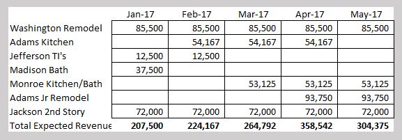

The weighted average revenue divided by the duration provides the estimated potential monthly revenue. You can then assign it to the months that the job may take place, as seen in Table 2.
Table 2
Table 2
Once you do this, you can plan ahead to move jobs, crews, and subcontractors to create a more realistic schedule. You can also use this to fit in the small jobs that may have more flexibility. Finally, you can use the monthly expected revenue to measure your progress against your total sales goal for the year.
