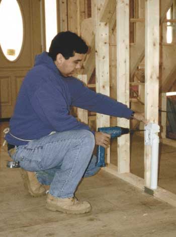

For best results, wait to install the tubing until the electrician and plumber have completed their rough-ins. That allows you to match the height of the inlet valve to the outlet boxes in the room and avoid conflicts with plumbing and wiring runs (Figure 4).
Figure 4. To avoid conflicts, central vac tubing is best installed after the electrician and the plumber have completed their rough-ins. Inlet valves can also then be mounted to match electrical box heights. |
