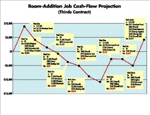

It's a wise and prudent contractor who works out of his customer's pocket. Take a look at the following two graphs. If you chart the expenses and income on your own jobs this way, will your jobs look like the first example -- cash negative for most of the job? If so, you have taken on the burden of financing every job with your own money. You are not only in the business of construction but also in the business of being a lender to your customers.
This graph shows the cash status of Joe's room-addition job using his old contract. His cash on hand goes below zero during the fourth week of the job, and he does not go cash positive again until he receives his final payment at the end of the job. Any unexpected expense between the fourth and twelfth weeks could make his life very difficult.
Changing his schedule of customer payments improves Joe's cash-flow position drastically. Outlays are the same, but frequent small inflows keep him cash positive throughout the job.

Surprise costs on top of routine expenses can make life difficult. Without naming any real people, let me give you an example based on the kind of thing I see all the time. I'll call this business Joe's Construction. If Joe's experience reminds you of your own business, you might find my recommendations helpful.
Joe is a good mechanic and puts his jobs together well. He estimates accurately, and he knows his markup: He multiplies his estimated job costs by 1.48 whenever he prices a job. He can expect to make a fair profit on every project.
Joe is selling a room addition with a half bath. In his contract, he describes the job in detail and concludes with the following payment schedule:
Total price for labor, materials, and other costs |
$37,500 |
One third down |
$12,500 |
One third at completion of two thirds of job |
$12,500 |
Balance due when job is complete |
$12,500 |
I don't know why so many contractors use this "thirds" formula in their contracts, but I see it all the time. This room addition will take 10 to 12 weeks to build. Joe figures that the $12,500 down payment will easily carry him until the progress payment in six or seven weeks. The customer signs the agreement, and he starts the job.
Joe's overhead is just over 30%, so he takes 30% ($3,750) from the first customer check to pay overhead bills. He's always careful not to draw on his profit until the job is done and all the bills have been paid.
He spends $1,250 getting the plans drawn and another $475 on the permits. He orders special windows that require an up-front payment of $1,850. He pays the excavator $800 as soon as he is done, then the concrete guy wants half his money up front and the rest -- a total of $435 -- within three working days of job approval by the inspector. Payroll comes to $450 for the second week and $1,600 for the third.
By the third week of the job, Joe has just $1,455 left of the original down payment, and it will be a good five weeks before he gets another payment. That won't begin to cover his payroll, and there will be more suppliers and subcontractors asking for money before then. But he isn't worried, because he has other jobs in progress. He assumes that he can move money back and forth as needed to be sure he is covered.
Joe thinks he has things well in hand. But two weeks after the room-addition job starts, the transmission breaks down in his main work truck. Boom: $1,850 to get it fixed. Then his insurance agent calls and says that his general liability insurance premiums are going up, and payment is due before the end of the month. Joe had also purchased several pieces of equipment from one of the big box stores, and his first payment is now due.
Soon Joe has more bills to pay than he has money. The payment schedules that he has written into his contracts mean that his company receives only two or possibly three checks during a typical month. He now finds himself robbing Peter to pay Paul. He'll need to take money out of pocket to keep going until the next payment comes in. He may even be tempted to take the down payment for his next job and apply it to the current job's costs.
