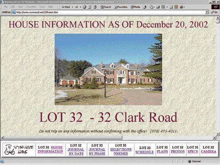

At first, I thought the only documents I could put online were html web pages, but as time has gone on, I’ve figured out ways to get almost any kind of document uploaded to our website, even paper building permits, plot plans, and invoices (Figure 3). Some documents (for example, a project specification) are put on our public website, where they can be viewed by anyone, while others (like a time card or an invoice) have hidden locations to keep them more private.
Figure 3.Each section of the “house information” is linked to the actual project document that can be viewed online. Here a scanned version of the building permit created with an HP K80 multifunction fax-scanner-printer is shown.
