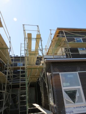

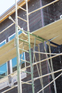

The back of the work platform requires railings, but the front side remains open to allow access to the work. However, the side next to the building must be kept within a specified maximum distance of the wall, which can pose a problem at pop-outs.
Outriggers are one way to extend the platform closer to a wall.

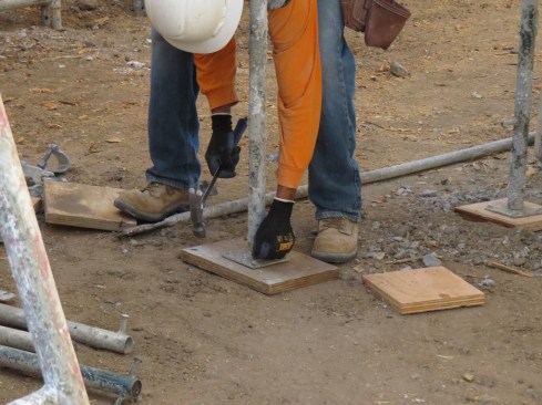

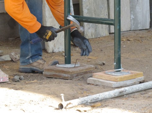

Base plates are mandatory on any scaffold, inside or outside. When set on soil, the base plate also should be securely attached to a mud sill, as shown here.
The base plate should be pinned to the scaffold as provided by the manufacturer, unless the plate is snugged up directly under the pipe of the scaffold frame leg.
The installer is digging out the ground and placing an extra sill block to hold the plate against the frame.

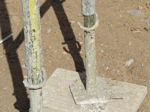

Pins for the base plates shown in this example need to be placed into the holes provided; the pin in the foreground in image is correct, but the pin at rear, set underneath the pipe, is a violation that has been known to cause failures and injuries.

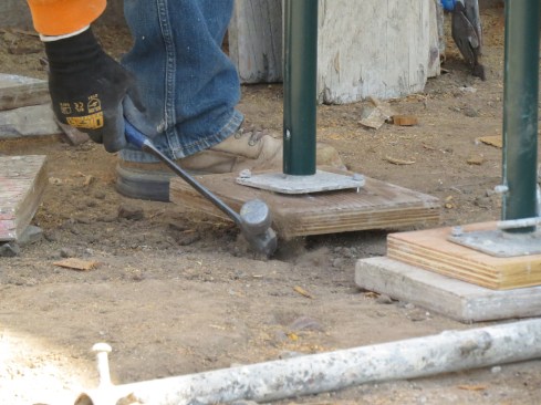

Indoors or outdoors, scaffolding requires base plates (see photos). They’re useful for leveling the legs, but they’re vital for stopping the legs of scaffolds from sinking into the soil or punching through a floor. Like any manufactured gear, they should be used according to the manufacturer’s instructions—if they come with pins and holes for connecting to the pipe scaffolding, the pins need to be set into the holes as directed.
When placed in contact with earth, the base plates need to be supported by “mud sills,” which, in California, should be at least
2 inches thick and 10 inches square, or equivalent (though a 10-inch-by-10-inch piece of 1 1/8-inch plywood is a compliant alternative).

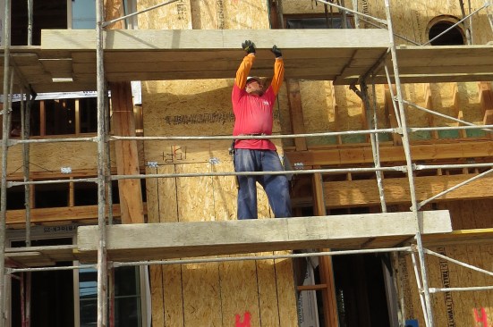

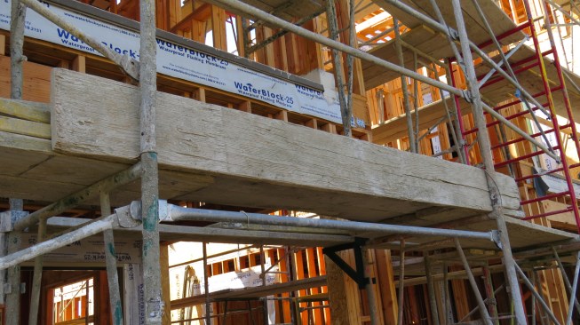

By rule, the working platform should be fully planked; missing planks will draw OSHA’s attention. Cross braces can be used as top rails or mid-rails, but only if the crossing point of the braces falls within the correct range of heights. But the management problem of scaffolding goes beyond the fine points of the rules.

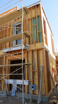

Workers had already begun to use the partially completed scaffold above, even though it had no end rails in place. The builder’s superintendent who noticed the situation stopped the work and “red-tagged” the scaffolding as off-limits, using caution tape.

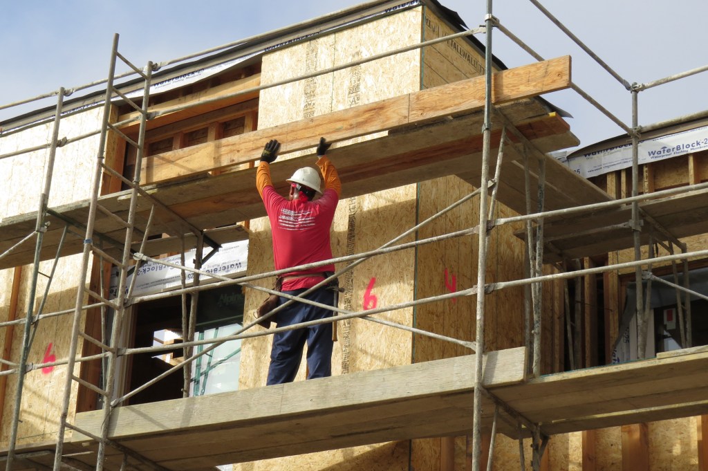

Scaffold working platforms need top rails and mid-rails at specified heights. Cross-bracing (also required) can serve as a rail, but in that case, the cross point of the braces must also fall within a prescribed range of heights above the working platform. You can probably count on professionally erected scaffolding to comply with those rules, but making sure the railings stay in place is another matter; in the photo below, workers have removed a mid-rail to load components onto the scaffold, creating a citable hazard.

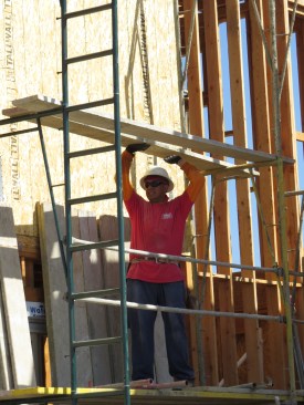

A worker for the scaffold-erection contractor sets a toe board above an access point to the building. This prevents falling objects from striking workers as they go in and out.
He wires the board in place.
Older planks that won’t pass inspection on the working platform might still do good service as toe boards.

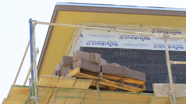

The danger posed by objects that could fall off the scaffold is real: In this example, workers loading a pallet of corbel trim blocks onto the scaffold have removed the mid-rail. This situation, which the superintendent corrected during his inspection, created multiple risks for workers using the work platform, as well as for workers passing beneath it.

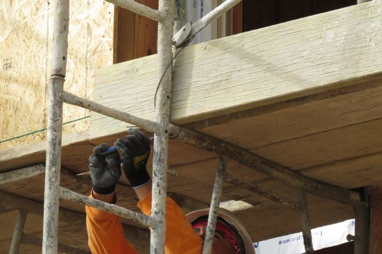

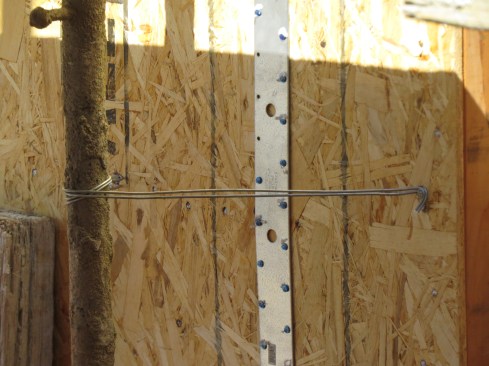

To prevent toppling, scaffolds should be tied to the building at the scaffold ends and at intervals in between (the horizontal and vertical spacing depends on the height of the assembly). It’s a good idea to install extra ties, since some may get cut during the course of work. Superintendents on multi-employer jobsites should keep an eye out for ties that have been cut and not replaced.
Multistory scaffolds require wire ties to secure them against toppling.

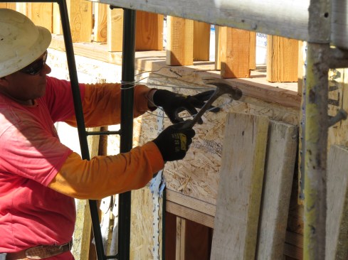

To place the ties, the scaffold erector drives duplex nails partway into the framing, wraps the wire loosely around the scaffold and the nails, then drives the nails home to tighten the wire.

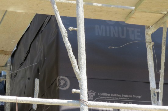

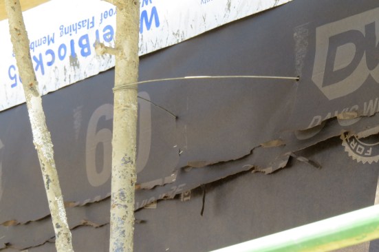

Wire ties create an ongoing inspection problem for the jobsite superintendent. Trade workers should not remove any wires while installing building paper or stucco.
Sometimes wires get disconnected. If a wire is in the way of trim work, another wire should be installed before the problem wire is removed or cut.

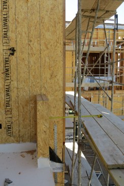

Distance From the Wall
OSHA rules set a maximum allowable distance between the work platform and the wall. In California, that distance is 16 inches, although the federal requirement is 14 inches.
This rule creates practical problems when the wall being worked on has jogs or pop-outs. In those situations, outriggers may serve to get the working platform closer.
