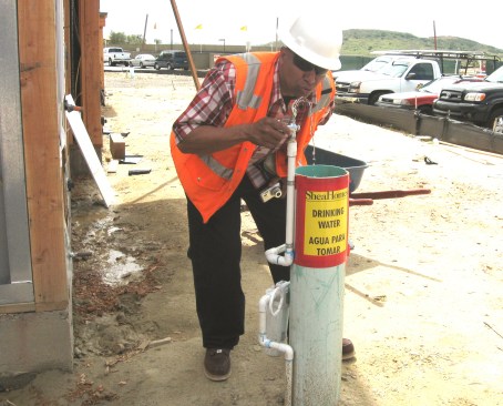

Every contractor or subcontractor with employees on a site is required to supply water for its own employees. That’s not the developer’s responsibility. But developers or general contractors are free to supplement the employer-supplied water if they choose to do so. Here, the author takes a drink from a water fountain set up by Shea Homes, the developer and prime contractor on this site. Shea routinely makes water fountains available to all the workers on sites they control.

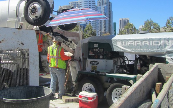

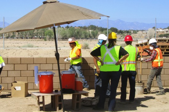

When a person is working hard in hot weather, the body cools itself by sweating and evaporation from the skin. The body loses water, and blood volume decreases. So we need to replace that water. In hot weather, supervisors should constantly remind workers to drink plenty of water—before they start, while they’re working, and during breaks. Under high-heat conditions, those rest breaks should be more frequent.

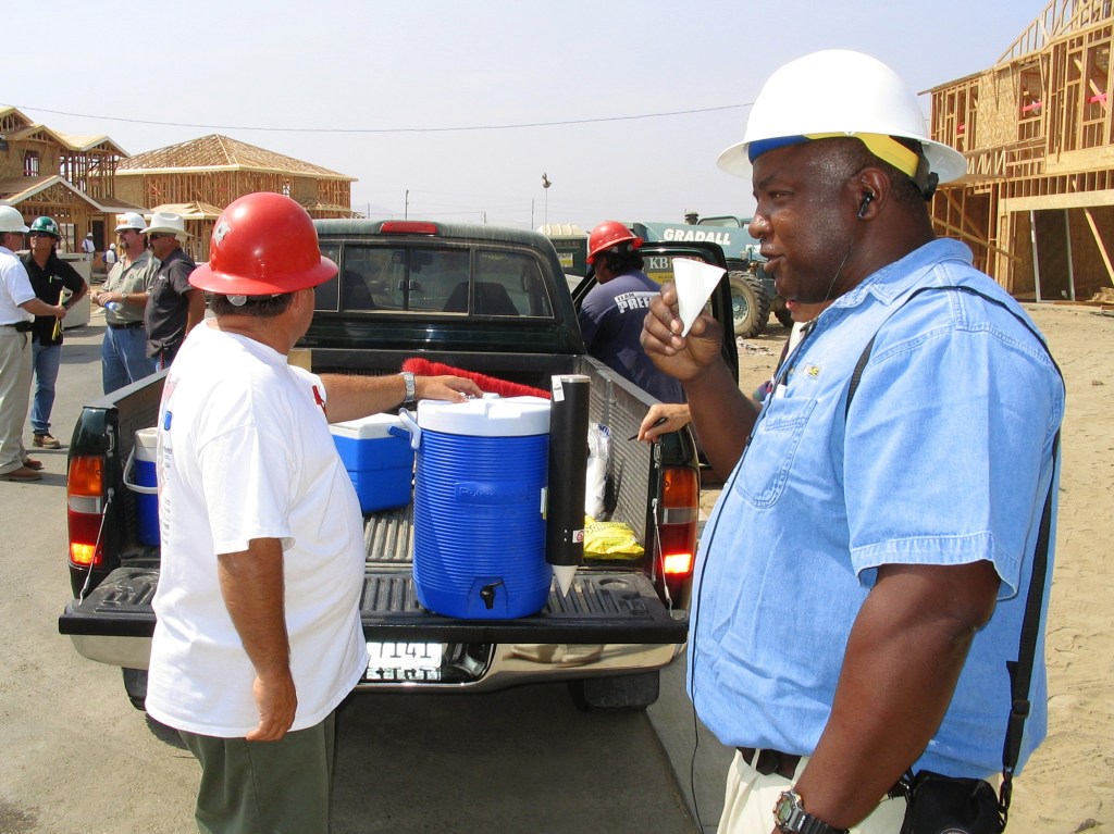

How much water? The rules require employers to supply enough water for every employee to drink a quart an hour for the whole working shift, free of charge. For an 8-hour day, for example, that means two gallons per worker.
You have lots of choices for how you supply the water: You can set up a large container with paper cups, install a drinking fountain, or give each worker his or her own water container. If you do supply individual containers, they have to be labeled with the worker’s name. And there has to be an easy way to replenish the supplies when they run low. I was on site when a client of mine was cited by Cal/OSHA for an empty water dispenser: The inspector picked up the jug and shook it, and there was nothing in there but ice. One good solution I’ve seen is to hang a sign on the water spigot, and designate one employee to check the water jug and top it off each hour, checking off the sign each time.
Workers need periodic breaks to cool off, and the employer has to provide a shaded area for that purpose. There has to be enough shade to shelter all the workers who might require a rest break at the same time. The employer should also provide seating; workers should not have to sit on the hot ground.
And the shade has to be effective: If there’s enough sunlight coming through the shading fabric to cast a shadow in the shelter, it’s not enough shade. In the language of the standard, the shade has to be “as close as practicable” to the work area. For employees working on a roof, the shelter might have to be down on the ground. But you don’t want it to be a half-mile down the road.

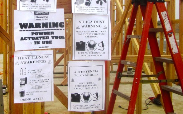

As with every OSHA standard, training and communication are big factors in Cal/OSHA’s enforcement of the heat illness– prevention rule. Here, an employer has posted warnings about heat illness alongside warnings about other jobsite hazards.
