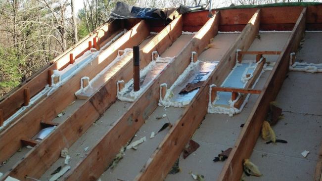

But a surprising fraction of those referrals result in contracts for much more extensive work. Like Wojcik, Bradley follows a “test in, do the work, test out” S.O.P. And fairly often, a thorough “test in” investigation reveals major defects in the building—issues that can’t be properly addressed with simple air-sealing and insulation. Often, Bradley ends up doing serious structural repairs, such as replacing siding, roofing, or even roof and wall framing assemblies.

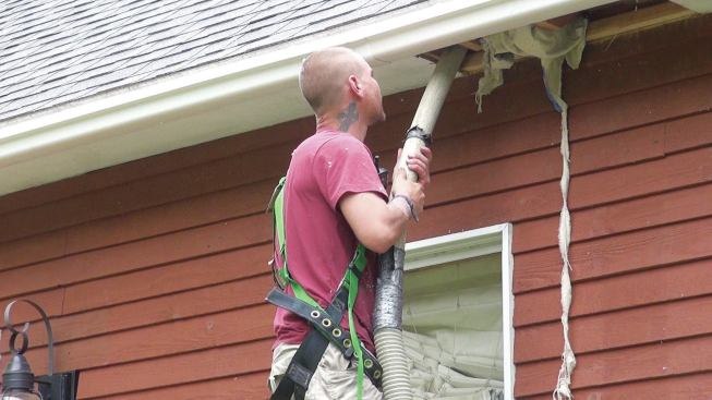

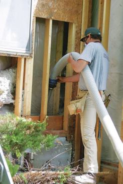

This summer, Bradley is reworking all the walls of a country house where settling cellulose in the 12-inch-thick walls left much of the house without insulation and plagued by moisture, rot, and pest infestation. With a cost of $130,000, the job scope is far beyond the typical home-performance project; but without home-performance diagnostics—namely, infrared thermography and moisture testing—the extent of the problem wouldn’t have been revealed.
In another case, Bradley’s crew came in to weatherize a house where a previous contractor had left the clients unsatisfied. “The contractor spent $8,000, but he hardly reduced the building’s air leakage at all,” says Bradley. “We spent about the same amount and cut the air infiltration in half.” The following year, the clients called Bradley back to insulate and finish a living space over the attached barn. The improvements to the attached structure, which adjoined the home’s kitchen, made the kitchen cozy and livable for the first time. “And now that they’re spending more time in the kitchen,” says Bradley, “they’re talking to me about a gut-renovation of the kitchen. It’s a foot in the door that keeps going, especially if you do a great job.”
