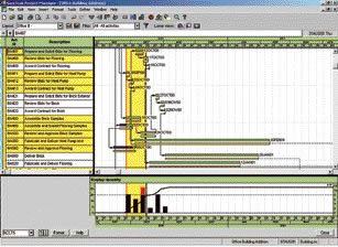

Feature for feature, SureTrak Project Manager 3.0 is similar to Microsoft Project, minus the web-based collaboration tools. It's nowhere near as user friendly, though, and of all the products reviewed here, SureTrak requires the most project scheduling experience to use effectively. That's not surprising, since SureTrak is the little brother of Primavera Project Planner (P3), which is the gold standard for scheduling big commercial construction projects like roads and bridges. In fact, SureTrak can be set up to share P3 project files, ideal for contractors and subcontractors who might have one foot in the commercial construction world.
Primavera SureTrak Project Manager uses the Progress Spotlight — the yellow areas — to help the user quickly pinpoint activities and resources.
For home builders and remodelers, SureTrak 3.0 has a few interesting features. Every license includes a copy of Project KickStart, a third-party wizard that walks users through the steps of setting up a project schedule. Project KickStart can integrate with ACT! or other contact managers to pull in resources without having to retype.
SureTrak also makes use of Fragnets, predefined snippets of a schedule that include activities and the relationships between them, which you can save and reuse over and over. Progress Spotlight is a one-click interface enhancement that highlights a range of dates in order to examine activities and resources.
Like MS Project, SureTrak can save views as web pages and has the capability to e-mail schedules and reports directly to project participants.
