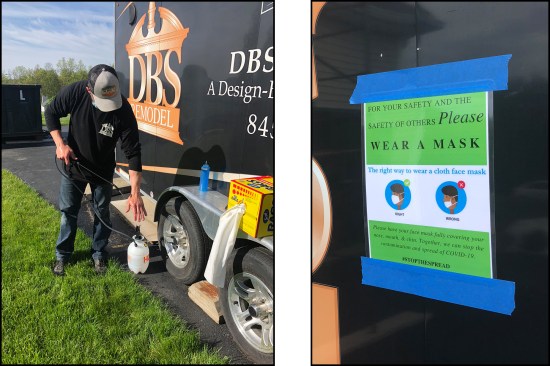

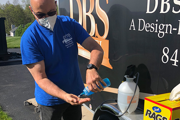

A hand-washing station (left) complete with hand soap, rinse water in a sprayer, paper towels, and hand sanitizer is currently mandatory on all jobsites (and will be after the pandemic, per company policy). An example of the laminated COVID safety signage prominently placed around the jobsite (right).
Looking to the future, jobsite procedures learned from this crisis, such as hand-washing stations and portable toilets, both with hand sanitizer, will be adopted post-pandemic. Using the homeowner’s facilities will no longer be an option—M.W.
