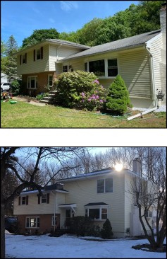

The “pop-up” addition was built over existing living space. The existing roof the lower single-story part of the house (top) was removed to build a new second floor for a master bedroom suite (bottom). The homeowners and their school-age children remained in the house during the project, working and attending school remotely online.

With the pop-up addition (shown in the photos on page 43 and above), we were able to slightly ease up on the safety protocols because the work area was separated from where the homeowners were. We had to build over existing living space, taking the roof off the lower single-story part of the house and adding a new second floor for a master bedroom suite. The job scope also included upgrading the existing electrical service, so we needed to schedule disconnecting power with the homeowners, who, along with their school-age children, were working remotely online.

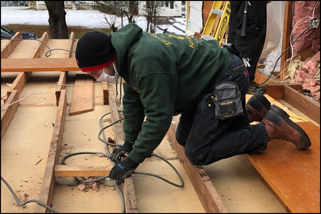

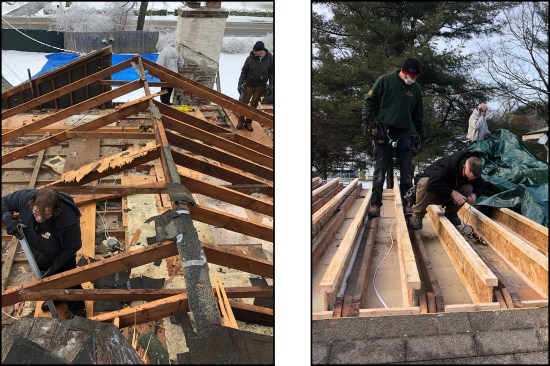

Working outside over existing living space in winter and maintaining 6-foot social distancing, carpenters removed existing roof framing (left), while electrical subs working closer together wore masks rewiring existing kitchen ceiling lights below (right).

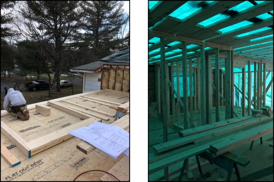

In a race to get the pop-up addition dried in, the DBS Remodel team worked 10- to 12-hour days during winter weather in temperatures 20°F and lower (left). A 60- by 40-foot heavy-duty tarp was used to tent off the structure as needed to keep snow off the deck; possibly snow melt into the occupied space below was avoided (right).

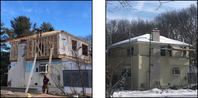

Demo work started on a Monday and the roof was weathertight by Saturday. Access to the second-level work area was by ladder only during dry-in phase (left). Here, workers finish up the siding on a bump-out for a walk-in closet in the new master-suite (right).

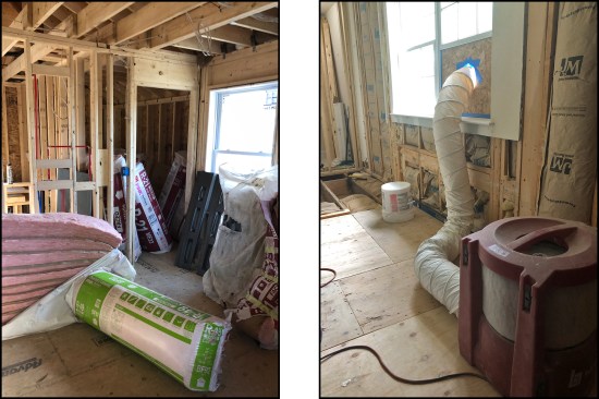

Lead times on materials such as windows, doors, and cabinets were long. Lumber and insulation supplies shortages led to improvising to meet schedules. Fiberglass batts (left) were often doubled up to achieve code-mandated R-49 ceiling — R-49 batts were scarce. A BuildClean HEPA air scrubber helped keep workspace air separate from a client’s living area (right).

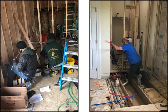

Inside, electrical subs working in close proximity wore masks (left), while a plumbing sub working alone wore a mask though it wasn’t required (right).

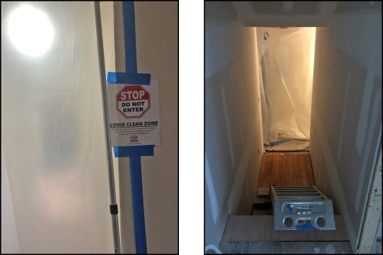

A “COVID Clean Zone” sign (left) was placed at the only interior access (right) to a new-master-suite work area.
