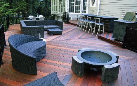

Hardwoods, although durable, need regular maintenance (Figure 5). They need cleaning and — unless the customer wants the weathered, gray color that some untreated hardwood turns — regular sealing. You have to manage your customer’s expectations. To provide a frame of reference, I tell customers that hardwoods weather like a teak patio table and warn them about the required maintenance.
Figure 5. Hardwood decking requires regular cleaning and sealing. Even so, many clients are happy with it as long as they are prepared for the inevitable weathering and maintenance.
