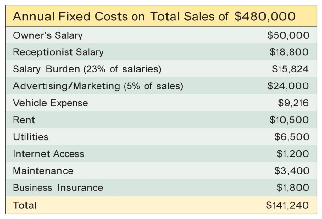

If you’re a small remodeler, your fixed expenses might look like this. These are expenses that occur whether or not you’re doing a project — such as office overhead, marketing costs, and nonconstruction salaries (including yours). The total of these costs is the “nut” you have to overcome simply to keep your doors open.

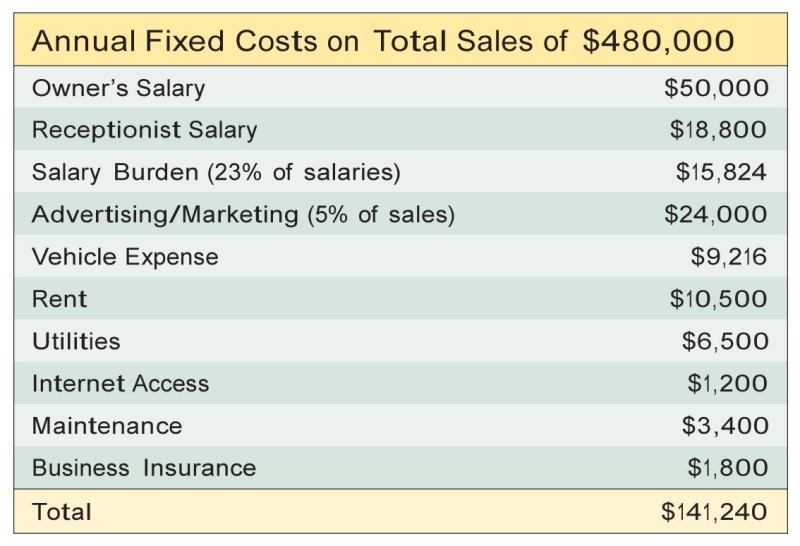

Fixed Expenses
Fixed expenses occur whether or not you build anything — they are the cost of keeping your doors open, and meeting them is what break-even is all about. They include:
All salaries and hourly wages not directly related to job costs, such as those paid your receptionist, estimator, and CAD operator, as well as your own salary.
The labor burden on those positions — Social Security, unemployment insurance, and any benefits you pay as an employer.
Vehicle expenses. This is a tricky category. Include only vehicle expenses that are truly fixed for the budget period — items that don’t change month to month and don’t go away if you subtract people or build fewer jobs, such as lease and loan payments, regular maintenance, and the like. (Treat vehicle allowances and mileage reimbursements for salespeople and superintendents separately.)
Advertising and marketing expenses. Even if you don’t actually spend a dime on advertising, budget something. (Use 5 percent of your sales if you’re a remodeler and 2 percent if you’re a home builder.)
Business insurance, including insurance on your building and its contents, general liability, and — if you’re a design-builder — errors and omissions insurance. (Be careful here, as some types of insurance are calculated against your gross sales or gross wages for the period.)
Office expenses: phone, utilities (for the office, not your job sites), facility maintenance (snowplowing, cleaning), repairs, and so forth.
