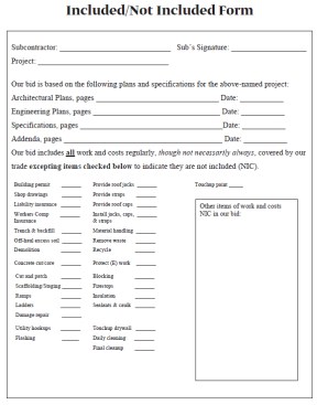

A subcontractor form that spells out items NIC (not included) in subcontractor bids can go a long way toward preventing items from slipping between the trades during estimating.

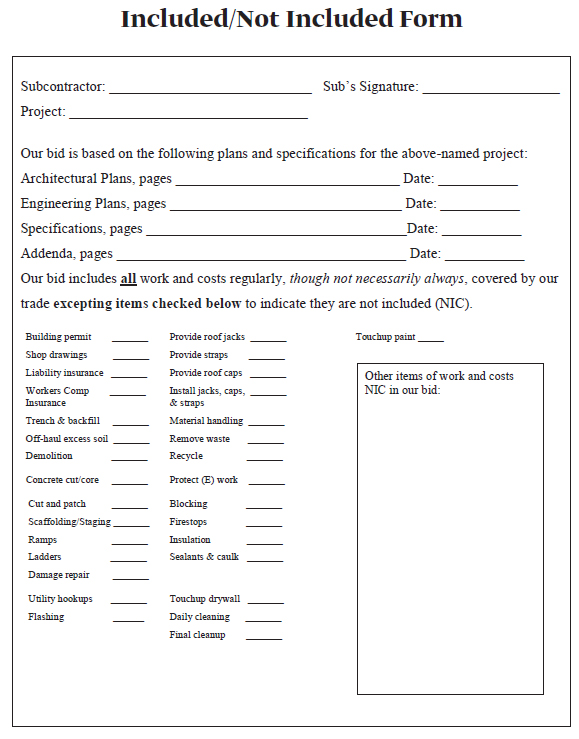

None of the many general contractors I interviewed for Nail Your Numbers had a solution to the problem of omissions that protected everyone: trade partners, clients, and builder. The only solution I have ever seen was developed by Jim Lunt, an outstanding plumbing contractor with whom I worked for years. Jim created an Included/Not Included (NIC) form specific to his trade. I have adapted that form into the more generalized form shown at left. It can be used for all trades—though it would be best used as a means of nudging subs into creating their own trade-specific forms.
Whoever creates the form, it should include these key components:
  • A stipulation that all work regularly, though not necessarily always, done by a trade is included in that trade’s bid.
  • A checklist of specific items that regularly fall between trades.
  • A space for the trade partner to list any items not included in their bid that aren’t covered by the checklist.
Of course, even a good Included/NIC form will not prove foolproof. Oversights can occur, especially when an item of work is merely implied by the plans and specs rather than explicitly called out. For example, plans may call for a skylight but make no mention of flashing at its curb because the designer assumes that any competent builder will know that a skylight curb must be flashed to the roofing. In that case, the flashing may get overlooked during estimating because the trade that is installing the skylight assumes the roofing sub will provide the flashing, the roofers assume they will install it but not provide it, and the sheet-metal guys figure someone else has flashing in their scope of work.
Technically, in such a situation, the “regularly though not necessarily always” stipulation in the Included/NIC form could be invoked by a builder. Relying on it once construction is underway and you realize that no one has taken responsibility for the flashing, you could insist that the roofer provide and install it. Or you could demand that several subs split the cost. For the sake of good, long-term relationships, however, you want to avoid jamming unanticipated costs down your trade partners’ throats. As a result, even after you have converted your subs to using Included/NIC forms, you may still end up chipping in on the overlooked costs now and then. But the forms should go a long way to reducing the frequency with which items fall between the trades during estimating.
