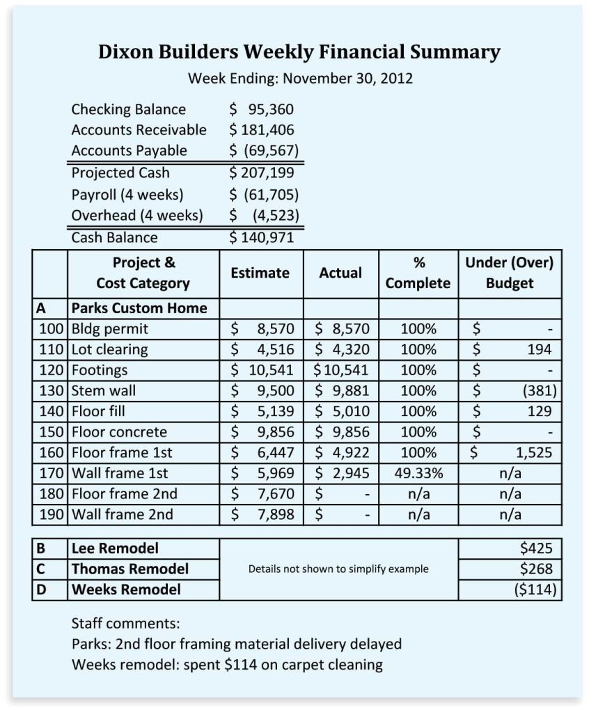

The author spends a total of 10 minutes each week with a financial summary and itemized list of active jobs like this one. At the top is a projection of cash flow for the coming weeks. The remainder of the form compares estimated to actual costs by project for major job phases. Cost overruns (negative values in the far righthand column) alert the author to change orders, and often lead to adjustments on remaining work to make up the difference.

The numbers are compiled in a report I run every Friday after any invoices in that day’s mail have been entered into the computer. It begins with a simple cash summary listing my company’s bank balance, accounts payable and receivable, plus payroll and other overhead obligations. I use this section to get a quick read on what my short-term cash requirements are and to make sure I will be able to cover them. In the example here, cash flow is good, but when the “Cash Balance” line approaches $10,000, it’s a signal that something has to be done to improve cash flow.
The rest of the report is where I spend most of my time. It’s organized by project, and because all invoices are coded according to the phase of work — electrical, drywall, roofing, and the like — the projects are broken down into those categories. For each cost category, as well as for each project overall, the report shows the estimated cost, the actual cost, the percentage of the task that’s been completed, and the amount by which the actual cost is under or over budget, each in a separate column. This lets me see at a glance how the job itself stands, and alerts me to any cost categories that are over budget.

For example, look at the Parks job in the sample report. It shows that the cost category “Stem wall” is $381 over budget. That’s not a huge overrun and the job overall is still under budget, but it tells me something didn’t go as planned. To find out what, I first look to the “Staff comments” section at the bottom. These are mostly taken from notes written on invoices by job supervisors, and are entered into the system along with the invoice amounts. In this case, the comment tells me the reason for the overrun.
If there’s no comment, I may know the reason from having talked with the project manager; in fact, the comments are often just a reminder, because I’m in close day-to-day contact with the project manager on each job, and I rarely have more than three jobs going at once. But if there’s no comment and I don’t already know the reason behind the overrun, the report has served its purpose by alerting me to something I may need to look into.
Sometimes an overrun is caused by something unforeseen — as was the case with the stem wall. In that case, I may talk with the job’s project manager about how we can tighten our belts in other cost categories to get the job back on track. Other times, an overrun may be caused by additional work that is out of the project scope. The action I take depends on how the individual job is performing overall, as well as on how all jobs taken together are performing.
For instance, sometimes a homeowner asks for a few extra electrical outlets. Typically, we will install them as a courtesy. (I actually think this is good marketing, and I make it a point to write a “no charge” change order.) But if the job is already over budget, our change order will charge for the work.
I also look at each job in the context of my entire workload. Say I have three remodels going, and my review shows a $500 cost overrun on one of them because of a roof repair. The budget for that job may be so tight that it would be difficult to make up the loss. But if my report also shows that the other two jobs are under budget, I’ll feel better about writing off the $500. I will certainly look to learn from the experience to avoid repeating the problem, but what’s important is that the company as a whole is meeting its earnings projections.
