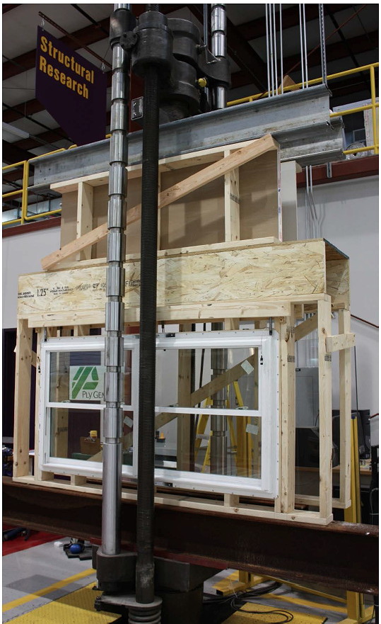

Engineers at the Home Innovation Research Labs loaded integrated band joist headers with more than 4,000 pounds per lineal foot to establish that the assembly could carry require roof, wall, and floor loads without compromising the performance of windows in the wall below.

But those changes are more complicated, and they raise engineering questions. Can a header integrated into the band joist really carry the required load? Will raised heel trusses topple if a wind load pushes the roof sideways? As the codes get tougher on energy waste, engineers are taking a closer look at the structural issues involved in meeting the energy code — and as data accumulates, framing solutions that work are finding their way out of the engineering lab and into the International Residential Code.
Engineer Vladimir Kochkin, of Home Innovation Research Labs (formerly known as NAHB Research), has been studying integrated rim joist headers and raised heel trusses, along with colleagues at the lab. A january 2013 report, “High-R Walls for New Construction Structural Performance: Integrated Rim Header Testing,” lays out the results of load testing for band joist headers that have to carry floor loads as well as wall loads. That study helped the officials revising the International Residential Code (IRC) to create prescriptive standards for rim headers, which have now been written into the 2015 edition of the code.
