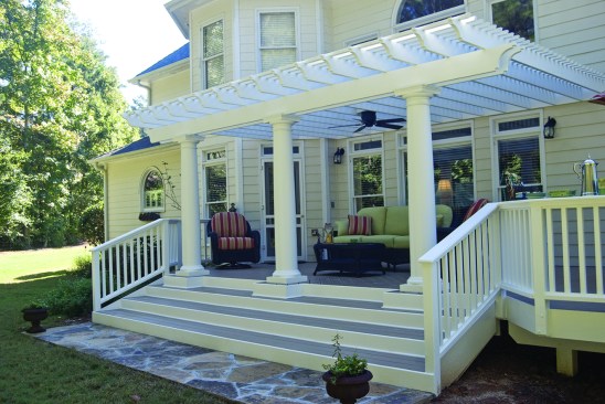

On more complex projects, several subs may be needed, as is the case for the many custom porches my company builds. I use subs for roofing, gutters, screens, painting, electrical, stucco, drywall repair, concrete, tile, and stone work (Figure 2).
Using experienced, quality-oriented subs makes my jobs look better and run smoother, with fewer callbacks. Good carpenters deliver my quality standard. Good painters put a long-lasting finishing touch on my projects. Good roofers reduce the chance for leaks, good electricians reduce the chance of sparks, and a good concrete finisher reduces the likelihood I’ll have to redo something that’s cast in stone.

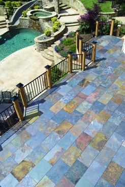

Occasionally, a larger project will require a firm estimate from my subs, but the established prices work in most cases and save a lot of time (Figure 3, next page).

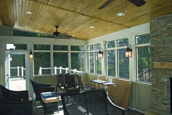

As a deck and porch builder, I don’t do very large jobs (Figure 4). Because of this, I end up paying, on average, a higher cost per square for roofing or per linear foot for gutters. Subs have operational costs just like you do, and they have to make money on the small- to mid-size jobs that you provide or you’ll be finding different subs every couple of months. Simply put, you have to make it worth their time, and that doesn’t just mean you have to pay them a decent rate. Being organized is equally important.
