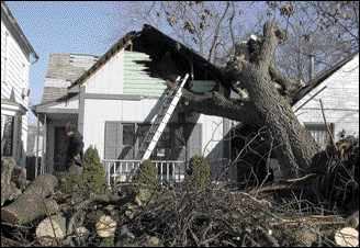

As a landscaping tree, the laurel oak is fast-growing, leafy, and tolerant of poor soil — qualities that have made it a popular choice for new homes and planned communities throughout the tree’s native range in the Southeast.
But the hurricanes of the past two decades have revealed a downside: the laurel oak topples in high winds. Studies of downed trees after recent Florida hurricanes have pinpointed the laurel oak as perhaps the most common of large trees to fall. “I’ve measured four hurricanes in the Pensacola area,” said Mary Duryea, urban forestry expert at the University of Florida, “and in every one of them, laurel oaks have wreaked havoc.”
Toppling trees prove to be a leading culprit in damaging houses during high-wind events. Builders and planners seeking to make new communities as hurricane-hardened as their houses have learned to pay attention to the kinds of trees they plant.
Used to be, tree falls were dismissed as unpredictable and uncontrollable. But urban foresters such as Duryea are bringing order to the chaos. By surveying urban canopies in the aftermath of hurricanes, they are learning how different tree species fare and how to plant and maintain trees to maximize survivability. The research is of interest not only to developers and planners but also to insurers, whose billions in payouts for the 2004 storms included millions for damage in Orlando and elsewhere inland.
Though it is not widespread, some have already called for trees to figure more heavily into insurance considerations.
Laurel oaks (Quercus laurifolia) “are such a risk factor that I would suggest that people’s insurance should be based on the types of trees they have,” Jim Lushine, a meteorologist with the National Weather Service in Miami, told the Lakeland Ledger last year. “I wouldn’t be opposed to even seeing some kinds of trees banned in Florida.”
By surveying urban canopies in the aftermath of hurricanes, they are learning how different tree species fare.
For developers and planners seeking to make new communities as hurricane-hardened as their houses, the message is to plant smarter. Fortunately, how-to information is becoming readily available. Those seeking an in-depth treatment can turn to landscape architect Pamela Crawford’s 2005 book, Stormscaping: Landscaping to Minimize Wind Damage in Florida. But a brief discussion is also available in the just-published “Assessing Damage and Restoring Trees After a Hurricane,” from the UF Institute for Food and Agricultural Sciences (downloadable for free at http://edis.ifas.ufl.edu/EP291).
The publication’s six authors make clear that planting smarter is partly a matter of choosing wind-resistant species. They list dozens of hearty candidates among palms, pines, and deciduous trees. Duryea’s research has shown that sabal palms (Sabal palmetto), live oak (Quercus virginiana), and southern magnolia (Magnolia grandiflora) are among the hardiest. Decay resistance is an important factor in wind resistance: live oaks tend to resist decay, while laurel oaks are prone to it.
How developers and community planners design tree layouts is also important, the authors note. They write that the most important and often overlooked design element is leaving enough soil space around the tree for its roots to grow. Trees expected to grow large should have at least 30 feet of unpaved space around their trunks; medium trees, at least 20 feet; small trees, at least 10 feet. Soil should be well drained, allowing roots to dig deep. “To provide anchorage for the tree,” the authors write, “roots need to spread beyond the edge of the canopy and grow deep in the soil.”
The authors also suggest that landscapers and developers group trees together in larger spaces rather than planting them singly in small spaces. This is to take advantage of trees’ natural tendency to support each other when bowed by wind. Even with the right species correctly planted, homeowners have to prune trees carefully to make sure they continue to be wind resistant, the authors note.
In a paper on tree damage following Hurricanes Erin and Opal in 1995, Duryea notes that the hurricane aftermath can leave neighborhood residents opposed to trees because of the damage they can cause. Yet trees have many benefits, such as shade, which helps homeowners conserve energy, Duryea writes. The implication is, the value of urban forests trumps their risks, especially when trees are planted and maintained to ride out hurricanes intact. — Aaron Hoover
