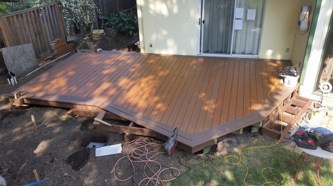

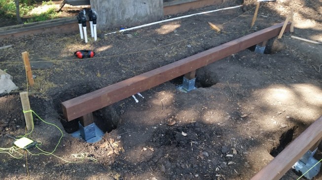

The Oz-Deck system is designed to eliminate both concrete and shovels, but on a recent project Houghton placed the posts in shallow excavations instead of at ground level. This was because he wanted the top level of the deck to be flush with the inside floor of a home that had been built on a slab. The company says that decks as high as 8 feet above grade can be supported with their system, but in general, Houghton limits his Oz-supported decks to no more than 2 feet above grade in order to avoid the diagonal and lateral bracing that would be required with a taller deck.

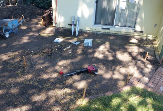

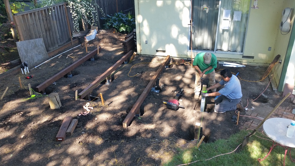

The post bases are typically installed on-grade using a jackhammer and a special bit that fits inside an insert placed in the base (left). On this project the post bases were placed in shallow excavations in order to keep the carrying beams close to ground level (above).

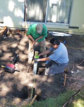

Houghton says that in the right soil it takes about a minute to drive in one of the Oz-posts with his electric jackhammer (which he picked up from Harbor Freight for about $600). The posts can also be installed manually – and tediously – with a sledge hammer. Ozco offers installation kits for either option, with both including a spacer that fits inside the post base. The jackhammer version of the kit, which also includes an installation bit for a standard 1 1/8-inch jackhammer chuck that fits inside the spacer, costs about $50.
Occasionally, explains Houghton, he’ll run into a rock or root and have to back out the post and relocate it; something to keep in mind if you’re building in bony soils. Getting approval from your building inspector may be a problem too, though Houghton reports that that is much less of an issue now than it was when he first started using the posts. Ozco says the system is suitable for use anywhere in the country for building a freestanding deck, but Houghton adds that he occasionally will use Oz-posts with ledger-supported decks, since he builds in an area with no frost. This works because the process of jackhammering the posts into place also compacts the soil under the plate and around the post, minimizing seasonal movement.
The author typically limits his use of Oz-posts to low freestanding decks on level ground, like this one.
