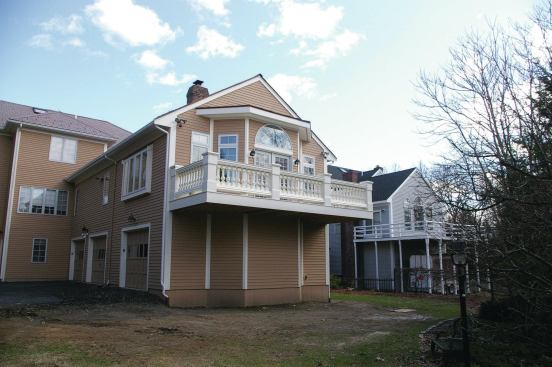

On June 15, 2015, a group of 13 students in Berkeley, Calif., fell five stories when the balcony they were standing on suddenly collapsed. Six were killed, seven were critically injured, and the incident became the latest example of the often-fatal consequences of poor building practices. The 4-foot-5-inch by 8-foot-10-inch balcony wasn’t overloaded; it was designed to support combined live and dead loads of more than 100 lb. per square foot (the code requirement at the time it was built). Subsequent investigations revealed a number of problems, however, including a leaky walking surface and a non-ventilated deck soffit that trapped water inside the deck frame, causing the engineered (but not pressure-treated) wood framing to rot.
It’s a sobering lesson for any builder who thinks a balcony is basically a cantilevered deck. Unlike a deck, which is supported by a ledger and a system of posts, beams, and footings, a balcony’s sole support derives from joists or beams that cantilever from the exterior wall. Its stability and longevity rely on the strength of the cantilever and a careful detailing of the exterior to protect the house and deck framing from water damage.

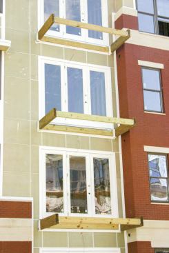

Flashing and drainage. In multifamily construction, balconies are often stacked vertically and built with an enclosed waterproof deck so that the upper balconies shelter the balconies on the floors beneath them. The joist bays are typically enclosed with an exterior grade of plywood that’s painted or covered with stucco to act as a finished ceiling for the balcony beneath. The problem with this type of assembly is that if the walking surface leaks, there’s no way for the framing to dry out.
In the Berkeley collapse, this proved to be a critical flaw. Reports indicate that although the balcony joists were covered with a waterproof membrane, the builders apparently neglected to include the necessary drainage board above the backerboard, which made the joists vulnerable to water that seeped through perforations in the membrane caused by fasteners. Making matters worse, the concrete walking surface was apparently not sloped away from the building as specified, which allowed water to collect and find its way through the concrete and the backerboard to the joists. Had the balcony deck not been enclosed, or had there been ventilation, it’s possible that the framing would not have rotted. And had there been a way to inspect the framing, the problem may have been discovered prior to the fatal accident.

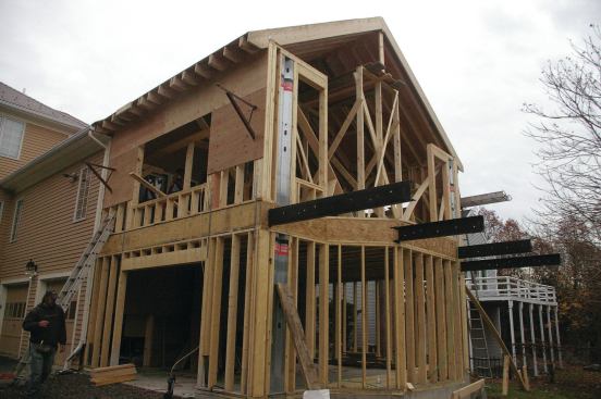

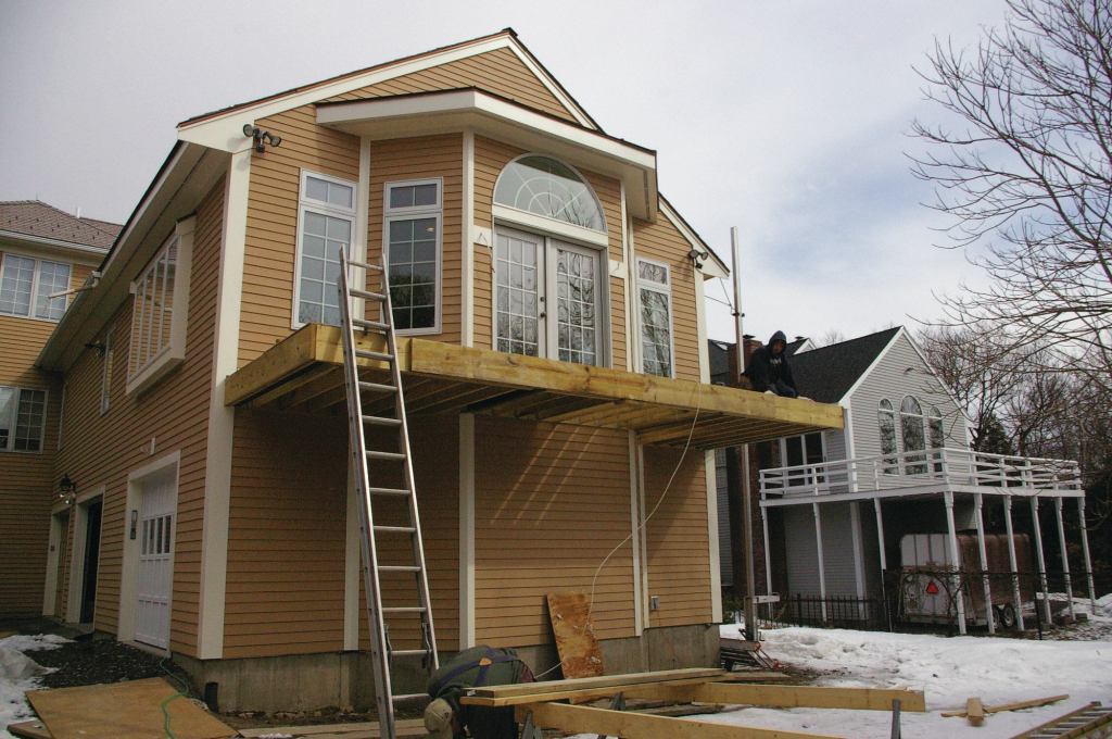

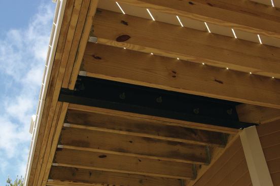

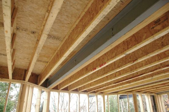

Cantilevered wood framing can be reinforced with steel, an approach used by Lenny Gillis, of Colony Home Improvements, while building a cantilevered balcony as part of an extensive remodel in Wellesley, Mass. While the project’s architect had initially specified pressure-treated 2x12s as the cantilever support, Gillis thought that was a bad idea. “The 2x12s were supposed to be sistered to the interior engineered I-joists, but in my experience, PT tends to twist when it’s used inside a structure,” Gillis explains. “In addition, we couldn’t get the lengths we needed to satisfy the required amount of cantilever.”
At the time of the build (2009), pressure-treated LVLs were hard to find, so he decided to use steel C-channel beams. After packing out the webs of the 14-inch-deep I-joists, he and his crew bolted four MC-10-22 steel beams to the interior joists. Cantilevered at the 2:1 ratio specified by his engineer, the beams were installed on 8-foot centers. They then ran pressure-treated 2x12s as perimeter and infill joists from a ledger bolted to the house’s rim joist. Adjacent joists and the rim beam were bolted to the steel. As to the cost, Gillis says, “I can see the cost-saving advantages of using PT LVLs, but they would fail long before the MC10s would fail.”

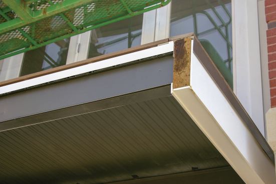

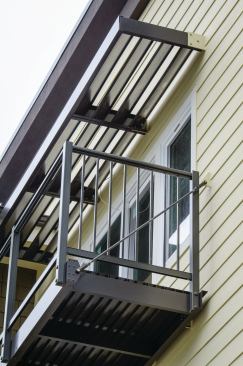

To prevent moisture problems, some companies offer prefabricated aluminum balconies and balcony components. American Structures’ innovative system (americanstructures.com) also incorporates a pair of support or sag rods that run between the deck’s outer rim and the structure wall just above the railing. The rods and a sub-fascia ledger can be lag- or through-bolted into the interior framing. Though each balcony is engineered, all designs are based on standardized frame components that are bolted together on site, and include aluminum decking and railing posts. Owner Mark Weissenbuhler says that one advantage to this system is its ledger, which isn’t continuous but is made up of individual brackets. “The ledger actually sits 1/2 inch off the building wall to allow the water to flow freely behind our balcony.”

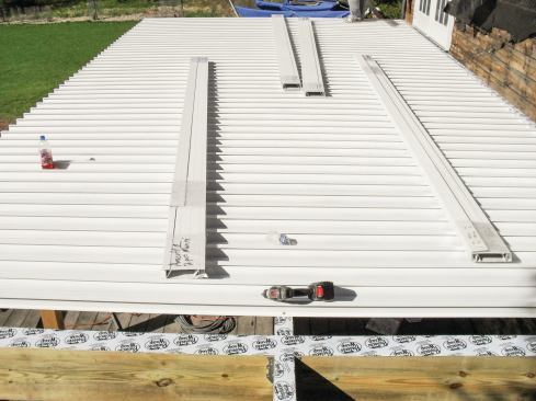

Another company that offers prefabricated aluminum balconies is Wahoo Decks (wahoodecks.com). While its Wahoo Complete pre-fab balconies are designed for multifamily construction, residential builders may want to look into the company’s Dry Joist EZ product. This is a component system of extruded interlocking aluminum joists that can span between 6 and 8 feet, making them well-suited for use with an engineered cantilevered frame. As a bonus, Dry Joist EZ framing is compatible with Wahoo’s waterproof aluminum decking system to create a finished ceiling below the deck.
