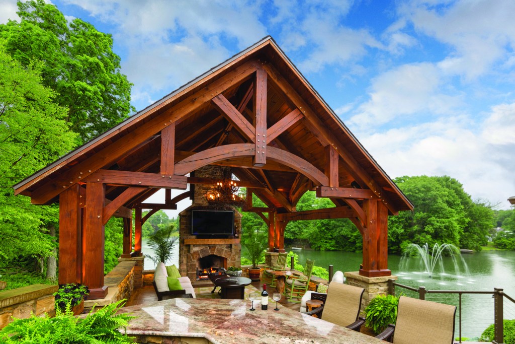

Dozens of tough hickory pegs pin together the mortise-and-tenon joints used in the construction of this 18-foot-by-19-foot timber-frame pavilion, located on Lake McClintock in Lima, Ohio. But hidden in the white-oak frame is a single peg made of purpleheart (a tough, colorful hardwood also known as amaranth).

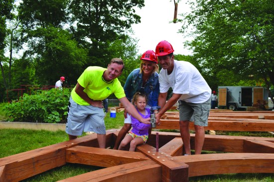

Family and friends are always invited to help assemble the company’s timber frames. Here, the pavilion’s purpleheart “giving peg” is being hammered into place.

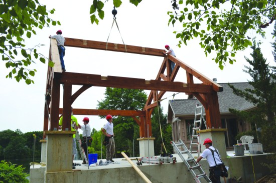

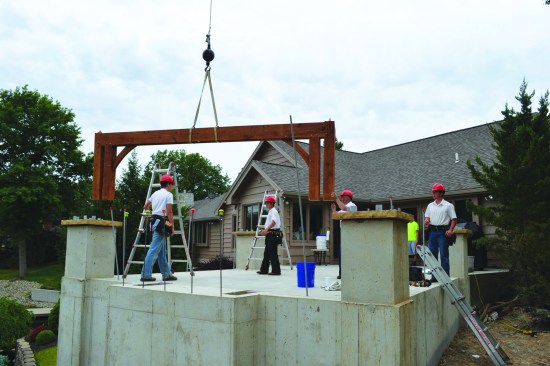

Once the components have been assembled on the ground, a crane lifts them into place, where they are installed by the OakBridge team.

In addition, unlike most timber framers, we use the “draw bore” technique when creating pegged mortise-and-tenon joints, offsetting the peg hole in the mortise and the peg hole in the tenon by about 1⁄8 inch. When the joint is assembled, the two holes are still slightly offset. Driving a strong hickory peg (stronger than oak) through the hole creates tremendous pulling power that draws the joint tightly together, even after the pieces dry out and shrink a bit. The technique is a must for tight-fitting joints.

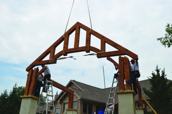

Crafted from 8x8 white-oak timbers with 8x12 plates, the 18-foot-wide frame has a 10-in-12 pitch roof. Above, a king post-and-strut truss is being lifted into position.
Crafted from 8×8 white-oak timbers with 8×12 plates, the 18-foot-wide frame has a 10-in-12 pitch roof. Above, a king post-and-strut truss is being lifted into position.
A 6x12 ridge beam ties the two end trusses together. For temporary protection, the pieces were coated with a water-based finish back at the woodshop.
A 6×12 ridge beam ties the two end trusses together. For temporary protection, the pieces were coated with a water-based finish back at the woodshop.
Raising the Frame
Typically, we send a small crew of three or four workers to the site along with the frame to prep it for raising. The next day, in what is truly a community event, most of our workers gather together with family and friends to assemble and raise the frame.

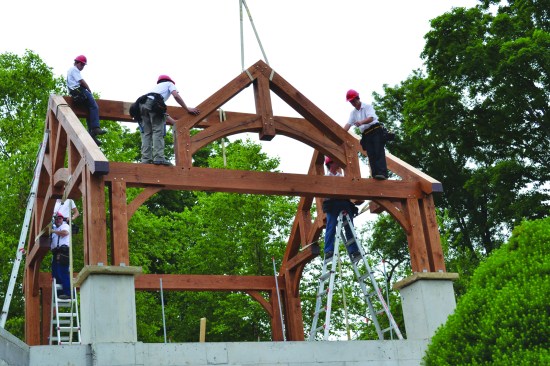

After OakBridge workers installed the dormer face truss and remaining 8x8 rafters to finish up the frame, a local crew installed a white-pine tongue-and-groove roof deck.

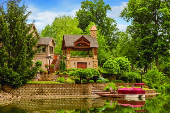

The project is located on Lake McClintock, a small reservoir in central Ohio.
