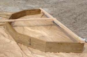

Figure 1. The mitered band board is first assembled and then installed as a unit. Blocks screwed to the bottom of the joists hold the band board in place while it's being installed. Note the doubling of every other joist.
We secure the joists to the house and the beam. Then we establish the center of the semicircle to provide a point of origin to lay out its arc. In this case, the center point is on the main part of the deck, set in from the edge by a distance equivalent to half the diameter of the porch columns and centered between them (see illustration, below).
Usually blocking must be installed between the joists so we have a place — other than air — to mark this point. If the center point did fall on a joist, we’d still block between that joist and its neighbors, to prevent movement and ensure accurate measurements.
The next step is to account for the railing. On the curved section, it will start at the porch roof columns and incorporate two 8-inch-square newels, which will be installed symmetrically around the curve. The band board will join with miters at the points where the newels will go. This will require a little calculator work. (see “Calculating Sides and Angles”).

Once we figure out the miter angle (15 degrees), the number of boards (six), and the length of each board (31 1/16 inches), we cut the members of the band board and screw them together into a unit (Figure 2).

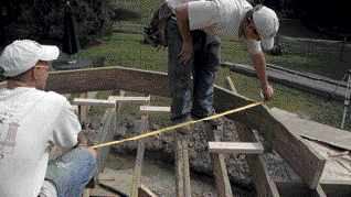

We confirm the numbers by making sure the two ends measure 10 feet apart and the projection measures 5 feet from the miter points to the center point (Figure 3).
Figure 3. Always double-check the band board's size. The distance from the points of the miters to the center point of the curved section should be equal to the radius.

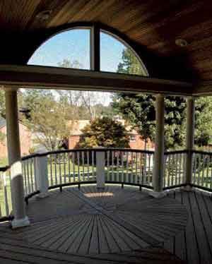

Fan Pattern
Any pattern of decking can be used on a curved deck. The trick is to let the boards run long and then cut them all off at one time. The decking here is cut into wedge shapes and fan-laid to radiate from the center point into the field decking (Figure 8).
Figure 8. Wedge-shaped decking boards make up the fan pattern. Dividing the circle into quadrants with a cross pattern facilitates installation and creates a distinctive motif.

To figure out how many boards you’ll need for a simple decking circle, first calculate its circumference: Multiply pi (3.1416) by the circle’s diameter, including the distance that the decking overhangs the band board or fascia.
You want the deck boards to be as wide as possible at the outer edge of the circle, to minimize waste. The decking we use is 5 1/2 inches wide, plus we allow a 1/4-inch expansion gap, for a total of 5 3/4 inches. Using a calculator, we divide the circumference by this amount; for this deck the result was 68.02 — close enough to call it 68 pieces, each with an end width of 5 1/2 inches. (When the quotient isn’t a whole number, we it round up to the next whole number and divide the circumference by that number to find the end width for each piece.)
After we’d cut the wedges using these calculations, however, the customer asked for a change — to add even more visual interest. We came up with the cross pattern you see in the photos, which meant all the wedges needed to be recut to accommodate the cross.
Though adding it was extra work, the cross looks good and even offered up an installation advantage. It’s easy to spiral out of alignment if the wedges or your layout is off by even a hair. By breaking the circle into quadrants, the cross made it a little easier to control loss or gain.
Instead of using the center point of the circle as the starting point for the wedge layout, we used the inside corner of the cross in each quadrant as a pivot point. The width of each wedge on the inside of the circle is simply a point, and the length is equal to the radius of the framing plus the overhang and minus the centerpiece.
Because it’s important that the wedges be uniform and have straight edges, we use a jig to rip them (Figure 10). After cutting the wedges, we rout their sides with a round-over bit to match the factory edge.
Figure 10. Straight-edged wedges require a jig. This is the sort of work where errors accumulate, so accuracy is called for from the start.
To save material, we try to cut overlapping wedges from the decking. We cut the pieces a little long so we can adjust them while we are installing them — we trim them after they’re installed. The pointy ends don’t need to be perfectly cut at first either, because they’ll be trimmed later to fit neatly around the centerpiece.
We use an installation jig to align the wedges radially (Figure 11). Essentially, it’s a piece of wood with a hole at one end that’s screwed to the center point on the deck. A “bulge” in the wood accommodates the screw, and the edge beyond the bulge is cut at an angle that mirrors that of the wedges.
Figure 11. Another jig aligns the wedges radially. Cut to mirror the angle of the wedges, this second jig revolves on the center point.
The wedges are adjusted in and out slightly to keep the margins correct. Once a quadrant is laid out satisfactorily, we screw it down using markings on the edge of the installation jig to keep the screws in concentric circles: There’s nothing worse than a precise pattern with randomly placed screws.
