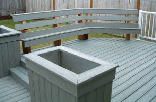

The white aluminum Ultra Rail railings (Metals USA; 410/752-6900, metalsusa.com) offer a look of security and balance, prevent the grill from falling off the deck, and give the lower deck vertical dimension. The bench with a seat back helps to keep the young one from inadvertently taking a tumble over the upper deck’s edge and affords comfort and relaxation for the adults who visit (Figure 3).
Figure 3. A bench provides seating for the grillmeister’s audience. Using two steps where one would have sufficed makes the level change more visible and therefore safer.
The transition between the two levels took some thought. I decided to place two steps between the deck levels. One step would have worked, but the eye tends not to pick up a single step down, which increases the likelihood of someone missing the step and falling or tripping. The planters further mark the elevation change; they also create a nice-looking transition while at the same time separating the two areas. Locally sourced stainless steel inserts inside the planters furnish “never worry” potting containment for plantings.

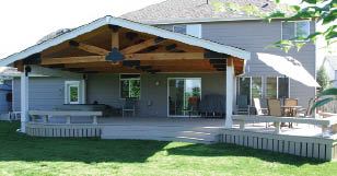

Shade and Shelter Increase a Deck’s Useful Season
In my next example, the back of the house faces west. The sun beat on the wall and caused the home to be too hot in the summer; during the rainy season (nine months), there was no protection from the rain. So it was usually either too hot or too rainy to use the original concrete patio, which wasn’t large enough for entertaining anyway. This made the customer’s backyard largely unusable for much of the year.
This customer wanted protection from heat and rain, a place to put a new spa, a covered portion of deck, and an uncovered area with benches to give the deck more class and function.
Budget was much less a consideration than it was with the previous deck, and I had some freedom to be creative (Figure 4).

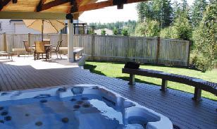

Figure 4. A roof shades a west-facing deck from the sun, and in the rainy season, provides protection for soakers in the hot tub.

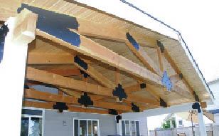

I designed the large open-beam roof to be the focal point of the backyard. For style and elegance, I added locally sourced decorative metal connections to rough-sawn Douglas fir beams (Figure 5) and installed 2×6 T&G pine car decking for the roof and ceiling. I curved the front of the covered end of the deck to help soften the angles of the house and the roof; the squared-off angles on the opposite end of the deck give proportion and interest to the design.
Figure 5. The author designed decorative metal plates to dress up the timber connections in the roof.
Benches form a barrier at the edge of a deck when railing is not required, but with an open feel (Figure 6). The curved bench adds a touch of class and usually becomes a focal point for guests. Skirting and fascia of the same material as the decking, Azek Deck in the brownstone color (877/275-2935, azek.com), contribute a clean, elegant look and hide any eyesores under the deck. The skirting also keeps pets and other large animals out from under the deck.
Figure 6. Benches define the edge of the deck without impeding the view as railings can.

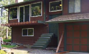

The customers in my final example wanted to enhance the curb appeal of their home and make it more welcoming. Entries to split-level homes like this one are challenging (Figure 7), as they often look narrow and uninviting. In this case, an adjacent second-story deck made the entry feel even tighter and overshadowed. Additionally, the second-story deck was cantilevered out from the house with non-treated 2x10s that extended beyond the roof eaves and were rotting on the outer ends (a common problem in the Pacific Northwest).
Figure 7. The old entry to this split level was uninviting. On the upper deck, the ends of unsheltered cantilevered joists were rotting.

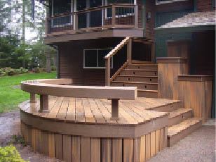

I designed a two-level entry with a 12-foot-diameter round deck to add character to and soften the lines of the house and landscape (Figure 8). I also cut off the rotted portions of the cantilevered joists on the upper deck, then installed new decking and rails. What remains is sheltered below the home’s broad overhanging roof.

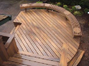

Figure 8. A round entry deck adds interest and focus, shifting the emphasis from the stairs to the front door.
The new front-door landing at the head of the stairs is large enough for guests to comfortably stand while waiting at the door but small enough to be an accent to the lower deck level. The 6-foot-wide stairs say “welcome to our home, we want you here,” and the combination composite and metal baluster railing adds simplicity and elegance to the look of the deck while forming a safety barrier. It’s constructed with Fortress round black pickets (866/323-4766, fortressiron.com), Fiberon post sleeves and skirts, and a deck board for the top cap.
I ran the Horizons decking (800/ 573-8841, fiberondecking.com) at a 45-degree angle to add interest. The lower deck shifts the emphasis from the stairs to the entry and is open and inviting to guests. The curved bench not only forms a barrier at the edge of the deck but is also a place to sit and a focal point. A single step off the back side of the deck accesses the yard, and lights in the risers make climbing the steps at night safer.
