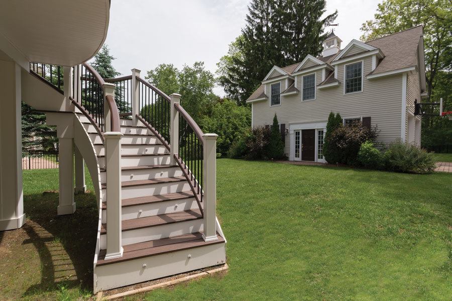

Our clients wanted to transform their ordinary 12x12 deck into a family living area, with features like an outdoor kitchen and a heated pergola to make the space more suitable for our northern New England climate. Because of the structural considerations in the project—including the weight of the built-in kitchen and the clients’ request for as much dry, open space beneath the deck as possible—we chose to frame the deck using Trex Elevations steel framing with RainEscape deck drainage.

Steel framing made forming the curves that figure so prominently in this design far easier than if we had worked with sawn or engineered lumber. In this article, I’ll describe how we built the curved stairs, but we used the same basic techniques for the built-in seating, pergola, and the deck frame itself.
Like the steel-framed deck itself, the landing for the curved stairs is supported by helical piles.

This curved stair has two landings, which are essentially just small decks. We took the same approach to building them, using helical piles for support, and using the same steel-framing techniques.
