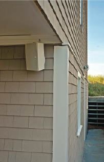

On-house placement (Figure 2) works well if you want to project the music onto the deck and into the surrounding area (large backyard, beach, pool, and the like). The speaker can be pointed downward to try to contain the music on the deck, but then neighbors behind the deck will hear it at a louder volume. On-house speakers don’t require you to make any special changes to the deck, so your job doesn’t change.
Figure 2. Placing speakers on the house provides sound to the deck, to the yard, and perhaps to the neighbor’s yard. Speakers facing inward from the deck’s perimeter take a little more wire, but the sound stays on the deck.
On-post placement, in contrast, restricts the sound overflow by directing the music toward the house. If the sound guy specs on-post speakers, you’ll need to coordinate with him so he can run wire.
Planter speakers radiate sound in a circular pattern (called “omnidirectional”). They can be placed almost anywhere on a deck and yield good sound. Like on-post speakers, they need wires run to them, so again, you’ll need to coordinate with your sound guy.
