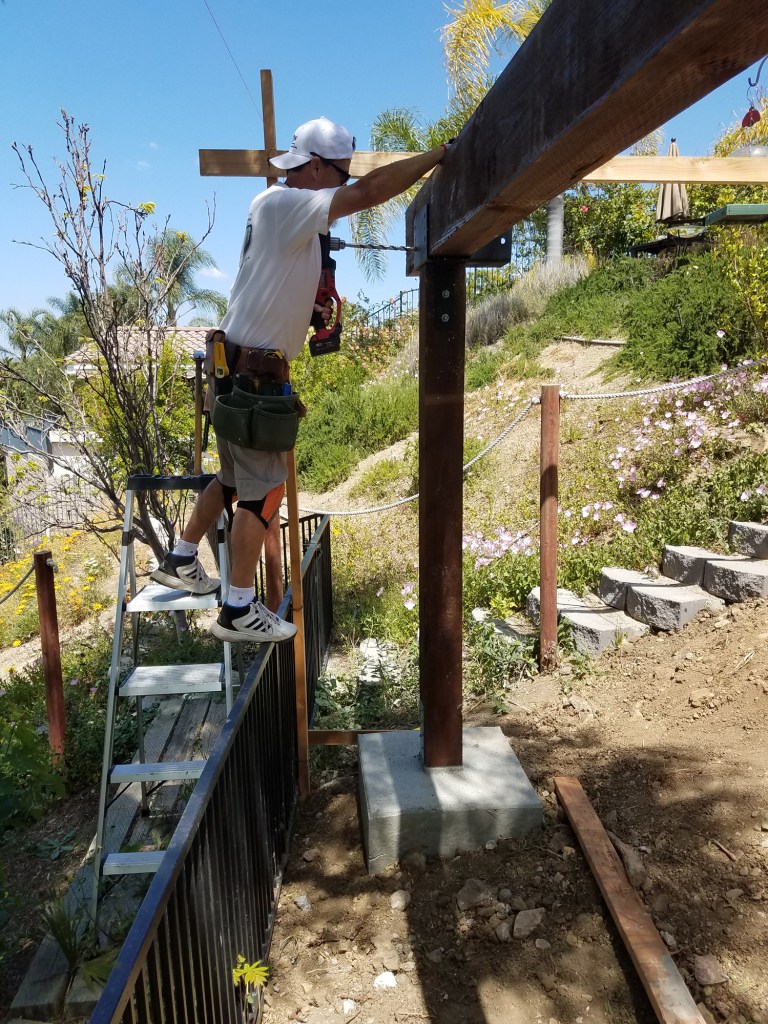

For years, 4×4 posts had been used to support decks with little thought to how much load the posts were carrying or how tall the deck was. That changed in 2015, when Section R507.8, a prescriptive method for sizing deck posts, was included in the 2015 International Residential Code. Prescriptive design is a cookbook for construction that eliminates the need for a design professional. However, like a cookbook compared with a chef, it’s limited in what it offers.
