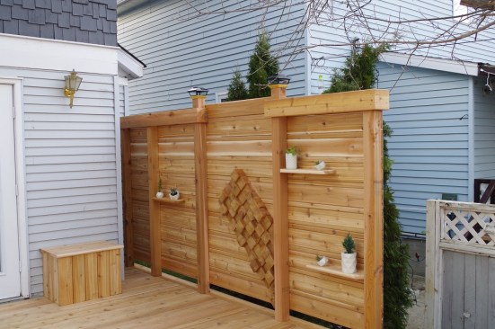

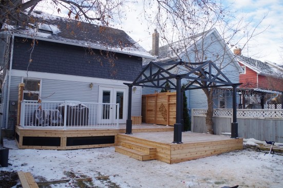

“No lattice,” my clients told me when discussing their proposed backyard project. Otherwise, they said they trusted me to come up with something creative for the design of a pair of privacy walls for the new cedar deck my company was building for them. On the south side of the deck, the cedar privacy wall only had to be long enough to block an unsightly view of their power meter. On the opposite side of the deck, the privacy wall is longer, so I created a focal point and broke up the wall’s symmetry with a geometric design made with blocks of cedar of various thicknesses.

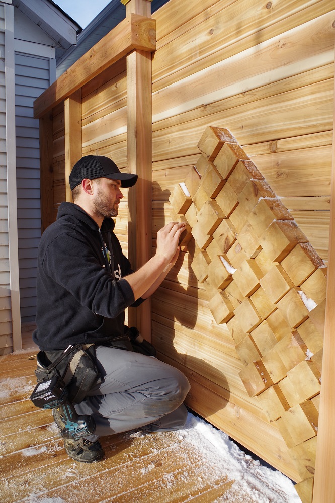

The end-grain pixel pattern that shoots up and out from the side of one of the posts is based on an idea that had popped into my head about six months earlier, when I had been playing around with designs for my own home’s backyard. Thinking that stacking cedar blocks with exposed end grain would create a feature wall with some interesting shapes and patterns, I went ahead and designed my idea in SketchUp to see what it would look like. I liked the design so much, I decided to poach my own idea and put it to use on this project.

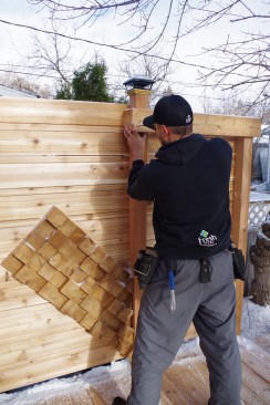

I cut the blocks in 1 ½-inch, 2-inch, 2 ½-inch, 3-inch, and 3 ½-inch lengths from a western red cedar 4×4 post, taking a palm sander to the face and corners to remove any splinters and smooth out the roughness from the cut. The blocks are fastened to the cedar fence slats with Titebond III waterproof glue and screws driven through the slats into the back of the block. To avoid potential splitting, we pre-drilled for the screws, and used a single screw per block.
To create the random pattern, I marked out the base line at a 45-degree angle, and then did a dry-fit with each row. Once the bottom row was installed, it was fairly simple to then dry-fit the next row. With five block sizes to choose from, I never had to place two blocks of the same size next to each other.
I briefly considered trimming the top of the wall with a traditional roman ogee-type trellis rafter. But this detail would have been a little out of character with the straight lines and boxiness of the other aspects of the wall, so I decided instead to just box the top of the wall with a cedar band, which I feels keeps the modern vibe of the whole project intact.
I capped the tops of the posts on either side of the design with light fixtures to gently light that portion of the wall at night. To stage the project for my clients, I placed a few succulents on the floating cedar shelves. Adding greenery always makes projects look so much cleaner and complete, and in this case the geometrical lines of the planters were a perfect match for the straight lines and modern look of the privacy wall. I had borrowed the plants from a local business, but my clients liked the look of the planters so much that they ended up buying them.
