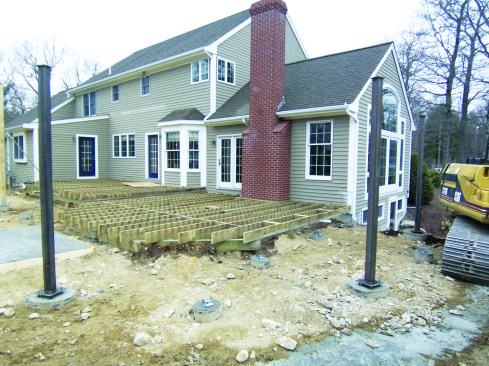

Planning started with a thorough survey of the existing deck. The 14-year-old pressure-treated deck boards were checked, split, and full of splinters, but since the joists and beams were in excellent condition (Figure 1), the ultimate design reused much of the existing structure. That meant we had to allocate significant time for power-planing the crowns in the old joists flat, because the PVC decking we were going to use would telegraph uneven joists and we didn’t want to end up with a wavy deck surface. In retrospect, it might have been more efficient to demo the old deck and start over — and it would have been nice to start new — but it would have cost significantly more for materials, plus demo, plus the time to reconstruct 700 square feet of sound deck framing.
Combining Loads Allowed for Fewer Footings

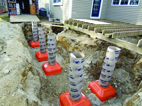

We designed the new deck beams to supplement the existing beams and footings and to provide support where the deck would be extended (Figure 2). The joists would cantilever past the beams and be trimmed to the radius later. The cantilever lengths varied, with the longest being just under 3 feet, which required both careful planning and some new footings.
We looked at the project from two angles. The joists had to run in specific locations to surround the hot tub, form the curved steps, and carry the pergola posts. Those joists dictated the beam layout, which in turn dictated a footing layout. At the same time, footings to support the screen porch and the pergola posts had to be in particular locations. By combining loads and adjusting supports to rest on footings that had to be there anyway for another purpose, we were able to eliminate several footings from the design (Figure 3). The remaining footings were sized to carry the combined loads.

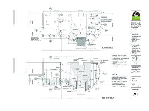

The plans for this deck were drawn on a computer (Figure 4). This was critical, because it allowed us to precisely locate the footings and radius centers — and that saved hours of head scratching in the field.

Installing the beams was straightforward. At the far right side of the large curved deck, where the beams ran nearly parallel with the joists, we put the footings and beams as far to the outside edge of the curve as possible (Figure 7). This allowed the last joist to be as close to the outside of the curve as possible (more later on why that was important).

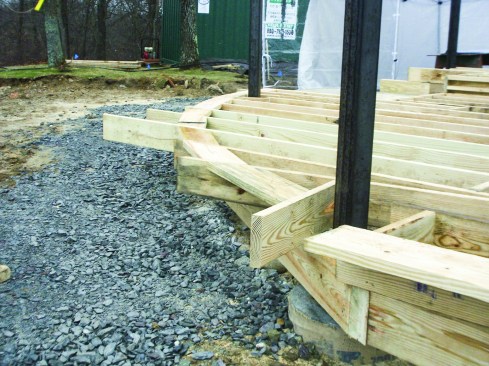

We initially ran the joists long and later determined the location of the ends with a template or a drawn arc. Each joist had to be cut at a different angle, which was evident from the arc drawn on its end.

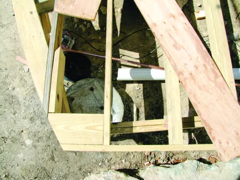

Before cutting the joists, though, we added blocking between the ends. The blocking serves three purposes. At the stairs, it’s a backer for the riser. It also provides continuous support for the curved picture frame and stair nosing, and it supports the butt ends of the decking boards, which run roughly perpendicular to the picture frame.
We ran the blocking long, like the joists, so we could cut the curve of the deck into it. This is where the curves of the deck really started to take shape. To locate the curve, we traced the templates onto the tops of the joists and drew plumb lines down both sides of each joist from the marks. We then numbered the joist bays, to keep track of which piece went where.
Next we laid a 2×8 across the top of the joists and traced the edge of the joists onto it. After numbering each segment (to match the bays), we cut the blocking along the scribe marks and made a duplicate for the lower blocking. The blocking was nailed flush with the top of the joists; we were careful to keep nails away from the edge of the curve marked on the joists. We set the lower blocking aside — it was numbered, too, so later on we’d know where it should go.
When all the upper blocks were in, we traced the curves with the templates. This gave a continuous line across all the blocking. We set a circular saw to just cut through the blocking along the curve. (You can easily cut curves to about a 10-foot radius with a single pass using a circular saw. Smaller radii will probably require two passes; you could switch to a jigsaw, but a jigsaw takes forever because you’re cutting with the grain.)
Next we laid the lower blocks directly over the upper blocks and traced the curve; one person cut them all while another got busy with a reciprocating saw cutting off the joist tails. Then we installed the lower blocking, making sure its face was plumb with the blocking above it.

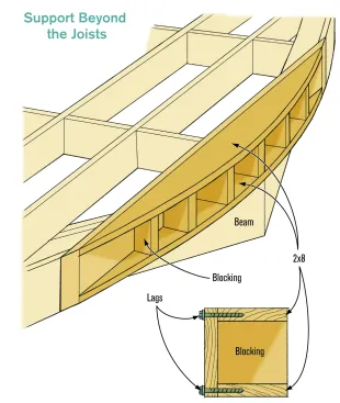

At one point — because of the curve, the beam location, and the joists running nearly tangent to the curve — blocking had to support the decking all on its own (Figure 9).
Here we lagged 2x8s parallel to the outer joist but oriented on the flat. We lagged one 2-by flush with the top of the beam and another flush with the bottom. The lags went into the edge of the blocking through the back of the joist. Then we added vertical blocks perpendicular to the joist as structural spacers between the “on flat” 2x8s. This is what carries the right edge of the curved decking. It’s a fine solution for this area, where no one can stand because of a fixed bench, but I’m not sure I’d love it for a high-traffic area like a step. If that had been the case, I’d have looked at framing this differently.

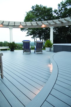

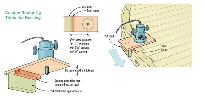

Installing the decking went much as it would on any deck — we started at the house and worked toward the outside edge. This deck required a decorative picture frame, so we had a couple of extra steps. We wanted a 11⁄4-inch overhang beyond the 3⁄4-inch riser on the stair and the fascia on the deck. With a deck-board width of 51⁄2 inches plus a 1⁄4-inch gap, that meant we had to cut the field boards 41⁄2 inches back from the face of the riser. Knowing that, we had kept all fasteners at least 4 inches back from the face of the framing. We made a simple router guide (Figure 10, page 38) to accurately cut back the decking parallel to the riser.
Once all the straight decking was installed, we installed the Versatex risers and fascia (Wolfpac Technologies; 724/857-1111, versatex.com). They faired out the little lumps and bumps in the blocking and provided a smooth surface for the guide to ride against. We finished the decking ends off with a 1⁄8-inch round-over bit to match the other decking edges.
