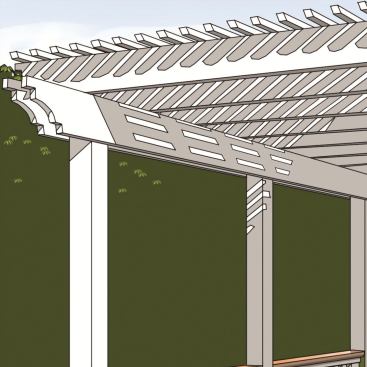

Bolting two cross beams together and attaching them to one side of a column can look too massive and heavy, so I prefer to flank the column with one beam on each side, for a lighter, more delicate look. On small arbors, we attach the cross beams flush to the sides of the columns with double 1/2-inch bolts. For larger arbors, an alternative is to cut a 1- to 11/2-inch-deep notch in the top of the columns. This method transfers the load to solid wood and to the bolts; another advantage is that the notches hold the beams in place during assembly. We locate the bolts within 11/2 inches of the top and bottom of the beam to help with lateral stability.
We lay out the joists so they are spaced evenly along the beam on approximate 16-inch centers and install them directly on top of the beams with toenails or toe screws, paying careful attention to blow-outs that could be seen from below.
I've seen some arbors where the joists are notched to drop down onto the beams. While this is an option, there isn't really any advantage to it. And it is possible that from below the gaps around the notches would be visible and unattractive.
For the final layer of the arbor — the lath that's installed perpendicular to and atop the joists — we rip 2x4s down the middle into long strips approximately 13/4 inches wide. You could use 2x2s, but the quality of those usually isn't great. Plus, the halved 2x4s are 1/4 inch thicker.
I like to install the lath 6 inches on-center, which provides just enough shade and looks neither too spindly nor too heavy. That spacing also helps to control joist bowing and warping. We face-nail the lath to the top of the joists with 10d hot-dipped galvanized ring-shank nails.

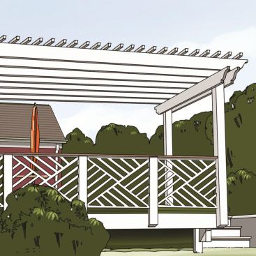

There are different ways to transfer an arbor's load. Freestanding arbors transfer all their weight to the supporting posts, while those that are attached to a house on one end transfer weight to the building and to the posts at the other end. It's not enough to simply nail an arbor to a fascia board or just notch the outer columns and rest them on a deck's 2-by outer band joist, which is only nailed to the ends of the deck joists.
We frame decks with a single band joist and double or triple joists on each end of the floor system. If we know that a deck we're building is going to support arbor posts, we will triple or even quadruple the joists under the posts' locations. We set the posts directly on the deck framing, making sure they bear on the joists and not just on the band joist, and then we install the decking around them.
For arbors on decks built close to grade, we attach the posts to concrete footings with post bases. Where possible, we also through-bolt the posts to the deck's floor joists.

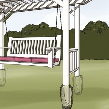

Freestanding Arbors
The advantage of attaching an arbor to a house is that even a single connection point gives the structure more stability. But our customers often want freestanding arbors, which require a combination of elements to work together to provide that stability. The grid made by the joists and lath, for instance, adds to the rigidity of an arbor, as does a well-built railing system between the posts. Though in general I try to avoid diagonal bracing, I will often use it on freestanding arbors over 10 feet tall or on large arbors without a guardrail system.
For a stand-alone arbor that can't be tied to a deck's framing — one located out in a backyard, for example — we'll dig 3-foot-deep postholes with 12- to 14-inch diameters and set the posts in gravel or concrete. To prevent rot on cedar posts, we paint them with aluminum paint up to grade level.

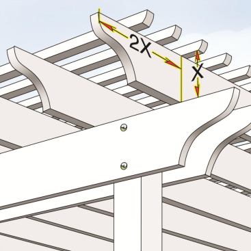

End Cuts and Overhangs
The right amount of overhang for the beams, joists, and lath makes a big impact on the overall look of an arbor, as do decorative end cuts on the beams and joists.
For beams and joists, the basic formula I use to determine overhangs is to add twice the nominal board width to each end. So, for instance, a 2x8 beam would extend 16 inches past the columns that support it, and a 2x6 joist would extend 12 inches past the outside edge of the beams that support it.
Lath pieces should extend no more than 4 to 5 inches past the edge of the outer joists. More than that and you're just asking for the lath to bow and twist over time.
For the decorative joist and beam ends, I draw what I think will look good, cut a pattern from 1-by stock, and then trace it onto the lumber. You can find endless design ideas online by searching for images of "decorative rafter tails." We then use a heavy-duty jigsaw to make the cuts and a belt sander to finish them.
