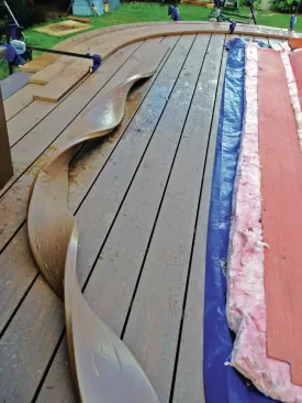

A recent design called for a 10-foot reverse radius. Since the deck had a 15-foot-square footprint, we built the layout box that size, using 2x6s set on edge. Then we rough-cut the framing and laid it in place, without fastening anything together.
To mark the curve on the joists, we made a 10-foot-long beam compass from a 2×4 and swung it from a pivot point located at the open corner of the deck. Then we figured out the angle of each joist cut line and cut the joists to their respective angles. Once everything was cut, we temporarily braced the curved side by screwing a pair of 2x4s to the tops of the joists. A 10-foot radius is fairly tight, so I heated the Trex 2×6 composite decking before bending it to form the rim joist. Besides holding the joists in place, the temporary bracing offered a convenient clamping surface for pulling the rim joist into place. Once the rim joist cooled down a little, I fastened it to the joists with Screw Products 3 1/2-inch #10 star-drive screws. Note that when you heat composite decking, the boards expand; when they cool down, they shrink. On this deck, the 2×6 rim joist was tight against the frame at each end when it was hot; after the 2×6 cooled, the gaps between the ends of the curved rim joist and the frame measured almost 3/4-inch.

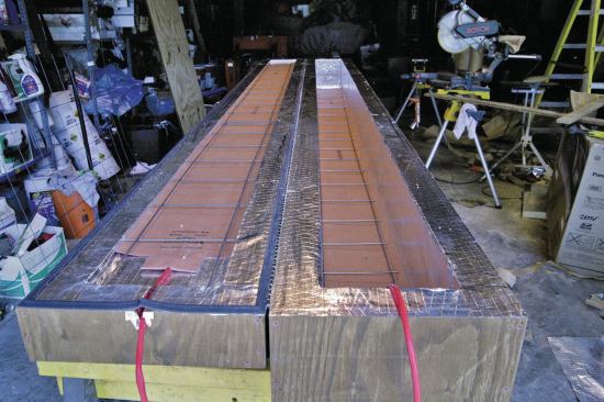

After cutting the framing to my radius, I fair out the curve by bending 2×6 deck boards on edge to the curve of the cut joist ends. If the radius is fairly tight, I heat the decking with heating blankets to make it more flexible (see Heat Forming Options).
Usually I need to build up the rim joist from more than one piece of decking, which generally is not as wide as my framing stock. When I’m framing with 2×8 joists, for example, I rip 2×6 deck boards in half. If I’m using 2×10 framing, I’ll rip a board to 4 1/2 inches for the bottom section of the rim joist, then conceal everything behind a single piece of 11 1/2-inch-wide fascia. I fasten the bent rim joists to the framing with 3 1/2-inch #10 Screw Products framing screws, predrilled and countersunk into the composite or PVC material.

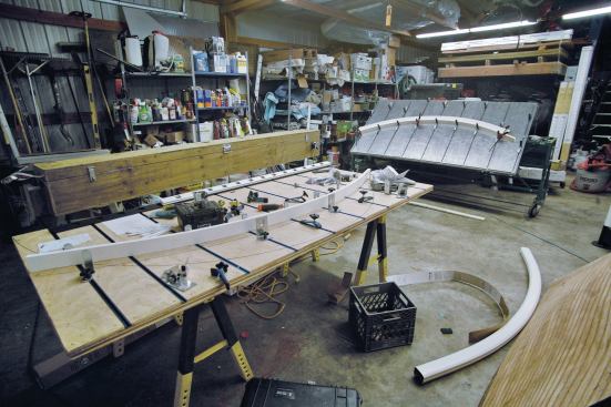

To prevent expensive mistakes, I always make jigs to trace curved cut lines on my decking stock. If the deck has curved surface borders, I prebend them in my shop using heat, then lay them out over my traced lines on the deck to verify that everything checks out.

On the project shown here, I finished off the deck with aluminum railing posts and a cable railing system. But it’s possible to bend composite and PVC rail kits using the tools and techniques described in this article. When bending railing, keep in mind that there are usually different technologies in one rail kit—some parts are PVC-wrapped composites, others are solid PVC products, while others may be made of something else entirely. This makes for variable heating times for the different components.
As you experiment with different products to create your own curved railings and other designs, you’ll find it takes time to figure out the best temperatures for bending various materials. Until you find the sweet spot—not too cool, so wrinkles don’t form on the inside edge of the part, yet not so hot that the surface gets deformed—you’ll likely blow through a lot of expensive material.
