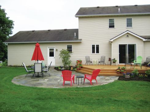

In my area, decks are considerably more expensive to build than other outdoor surfacing options. Depending on the design, an average ipe deck (my preferred decking material) costs my clients about $45 per square foot, and decks costing $50 and more per square foot are not unusual. Simple pressure-treated decks can be had for $30 to $35 per square foot, but most of my landscape clients aren’t looking for a 14×14 rectangular PT deck. They don’t have unlimited budgets, though, so we still need to be conscious of cost when designing their backyard living spaces. Our strategy? Incorporate a brick, stone, concrete-paver, or poured-concrete patio into the deck design. This allows us to cost-effectively provide large entertainment spaces and introduce interesting design details while maintaining easy egress from the house.
A patio is half as expensive as a comparable deck, with costs in our area ranging from $12 to $22 per square foot, depending on materials and details. This assumes that the patio is at ground level; a raised one can easily approach the cost of a deck. Including a deck in a patio project—or vice versa—adds value and allows our clients to have the best of both worlds: a deck surface to walk out on and perhaps a place to grill or to read the newspaper, and also a larger hardscaped area for entertaining.

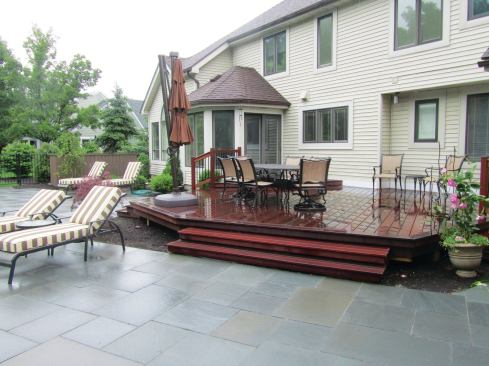

Even when landscaping clients don’t include a deck on their wish list, it’s often a practical solution, at least in the Northeast. Here, we have to deal with winter, and since many of our clients don’t let a minor inconvenience like a foot of snow keep them from grilling, we like to incorporate a small grilling terrace at or near the same level as the rest of the house. This way they can run out, throw a steak on the grill, and run back in the house before icicles form on their noses.

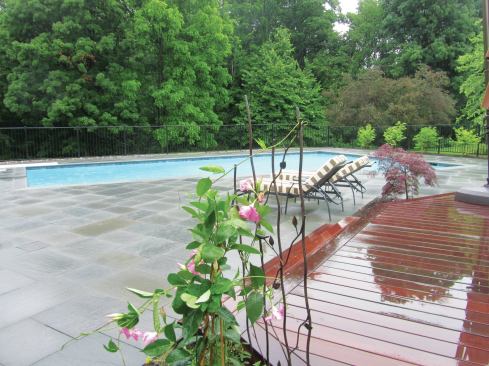

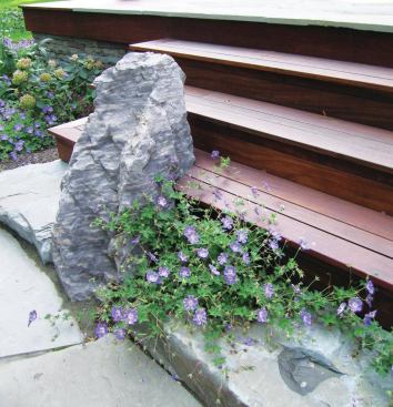

When designing combination deck-patios, we try to blur the lines that separate the two spaces. A simple detail like a boulder in an unexpected spot creates a Frank Lloyd Wright–inspired illusion that we have built the deck into a stone outcropping that was just too big to be moved.

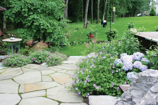

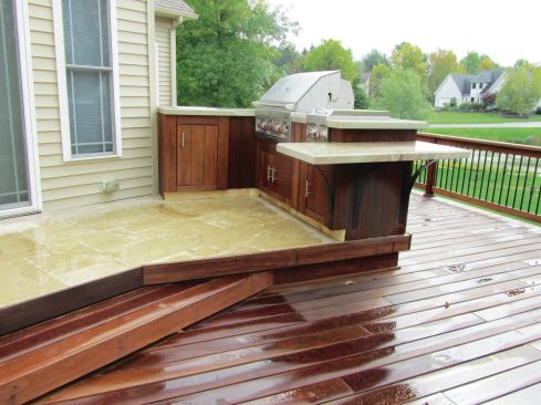

Often, we’ll inlay a portion of the deck with the same type of stone that’s used for the patio, which visually ties all the elements together. We’ve also added traditional landscaping details—such as stone fire pits and water features— to our wooden deck designs. Blending decks and patios like this adds a “wow” factor to our projects and allows us to create the coolest design for the least possible cost.
