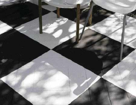

Avoid Film-Forming Finishes
Paint forms a tough film designed to block sun and water for long stretches of time. These attributes make paint ideal for exterior trim and siding, but they’re not advantages for a deck. Penetrating deck stains and sealers are designed to protect without forming a film.
As explained by lumber-industry veteran Ed Burke, who’s a member of the coatings advisory committee at the Forest Products Laboratory, film-forming finishes are very good at protecting wood, but they inevitably develop hairline cracks — particularly on a deck. When they do, rainwater will get beneath the film. “And then these coatings are going to do an equally good job of keeping it there,” Burke says. “The problem with that is that any time wood does not dry out between rainstorms, you have the potential for decay and rot.”
Opaque deck stains can be paintlike in this respect when too much is applied. Homeowners sometimes take a look at the result and think the deck needs multiple coats. Yet when they try to make the surface of the deck look as uniform as a freshly painted ceiling by applying more finish, the stain morphs into a film-forming finish.
“The problem is,” explains Burke, “there’s so much pigment in this stuff that if you put it on too heavily or you put on two coats, bingo — you’ve got an oil-based paint. It doesn’t matter what you put on the can. It’s paint because it forms a paint film.” Avoid the problem by following the recommendations of the manufacturer.
