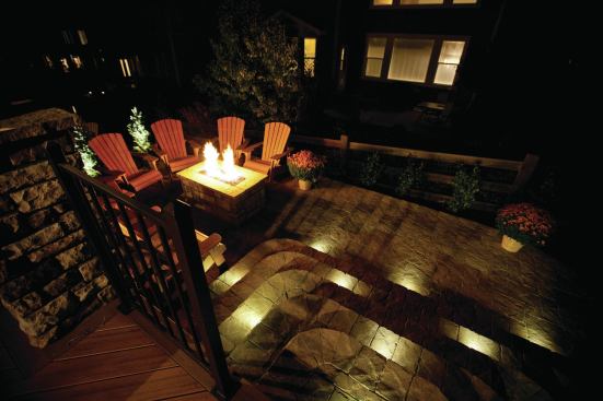

Decks are still my company’s bread and butter, but we’ve started offering hardscaping and patio covers too. The beauty of a low-voltage lighting package is that it can be added to any or all of these projects. Since low-voltage lighting runs on 12-volt DC rather than 110-volt AC current, it’s easy for my crew to install the fixtures and wiring, and most of the installation can be completed without an electrician’s services.

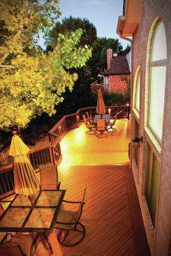

I make it a point to get great nighttime photos of our completed decks, which I use to sell not only our lighting packages, but also overall projects. To do this, we hire a professional photographer. The money we’ve spent on photos has been easily recouped by selling more and larger projects.

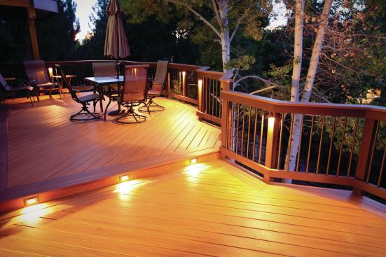

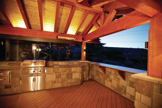

Our lighting designs always start with the effect we’re trying to achieve. For example, to incorporate outdoor lighting into our patio covers, we sometimes install light bars in the bays of exposed-rafter ceilings. These lights are usually wired to a separate transformer that’s on a switched outlet, which allows the client to turn these lights on and off independently.
We prefer to use LED fixtures. Though they are more expensive, they’re more compact and they require less power for each lumen of light output. That is important because the total wattage of the fixtures on each circuit determines the size (and cost) of the transformer used, as well as the gauge of wire required.

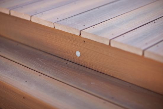

For example, I am a big fan of Dekor’s Deck Dots. They are the smallest, brightest, and easiest-to-install LED deck light I’ve seen. They are sold in fully contained kits as well as individually and are designed to be installed flush in any surface from maintenance-free decking to concrete.
