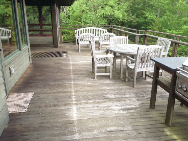

Located in the heart of Vermont’s Green Mountains, this slope-side ipe deck hadn’t been maintained since its installation 14 years ago. Note the drip line underneath the eaves.

Every wood species is different and every deck situation is unique—successfully finishing or refinishing a wood deck requires being an odd blend of forensic detective and math magician. When we arrive on the scene, the first thing we do is clean the deck, taking it back in time to the day you swept it off. Early-stage encounters typically require a low-pressure wash with mild cleaners, though sometimes there is a bit of power sanding too. It actually doesn’t matter much if it is a month or a year after installation; the process is the same, with the only variable being the intensity of the cleaning products we use. Then, we cordon off the area to let it dry out for a few days before we return to finish it.
Of course, when we return to apply finish to the deck, we have to shut it down for a few more days of cure time. In a best-case scenario, the mini-restoration costs the customer a week and a half of recreation time on the deck, and even more time if the weather fails to cooperate.
