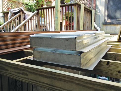

This prefabricated system consists of hollow 8-inch by 8-inch by 4-inch glass blocks contained within a structural aluminum frame. The panels, which weigh about 20 pounds per square foot, can support live loads of at least 60 pounds per square foot over a 5-foot span, according to the manufacturer. Because they are weatherproof and thermally efficient, they can, if properly detailed, even be installed as skylights over living space. Our installation was simpler, as we didn’t need to keep the area under the deck dry, but since the panels would be walked on, they needed a non-skid sandblasted architectural swirl finish.
The single 171/8-inch by 983/8-inch panel originally specced for our opening would have weighed about 250 pounds (shipping weight was 350 pounds). Access to the backyard of a Hoboken brownstone is limited, so to make the glass a little easier to wrestle from the curb to the back deck, we decided to order two smaller 171/8-inch by 493/16-inch panels, which would weigh only about 120 pounds each. Once the owner approved the design and the $2,400 price (plus $400 shipping), I forwarded a 50% deposit to the company to secure delivery, with a four- to six-week lead time.

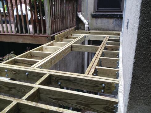

The original deck had been built at the same time as the addition it was attached to, and the deck joists had been pocketed through the addition’s masonry wall and fastened directly to the floor joists inside. On the opposite side of the deck, the joists were supported by a property-line separation wall built with 8-inch concrete block, with bricks laid between each joist.
After demolishing the existing PT decking, we lopped off the joists at the addition wall and removed the joists and bricks from the top of the block wall. To create a level sill, we filled the exposed block solid with mortar. We then lag-bolted the new ledger to the cut joist ends, reinforcing the connection to the 3-wythe brick wall with masonry anchors. We also bolted a PT sill to the top of the separation wall. One end of each new joist is connected to this sill, and the other end is hung from the ledger with joist hangers.

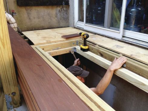

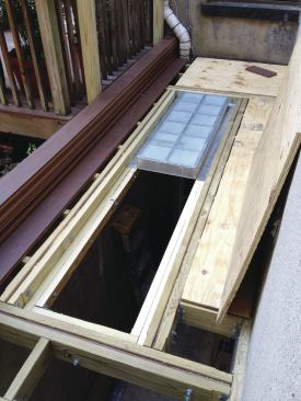

By the time we were ready to frame the new deck, the block-panel manufacturer had supplied us with a shop drawing and installation guide that provided us with the information we needed to frame the panel’s rough opening. Since we were installing two 125-pound panels into a 2-foot by 81/2-foot opening in a deck that measured 5 feet by 18 feet, we were concerned that the size of the rough opening and the weight of the panels would compromise the structural integrity of the narrow deck. We couldn’t easily use joists any bigger than the original 2x6s, so we reinforced the four sides of the rough opening with 1/4-inch by 5-inch steel plates sandwiched between doubled 2x6s, all bolted together.

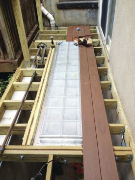

Once the rough opening was completed, we had to create a ledge for the panel flange to sit on. The thickness and height of the ledge was dictated by the 4-inch panel thickness and the 3-inch width of its metal flange. Since the decking measured 1 inch thick, we located the top of the ledge 3 inches below the top of the joists—4 inches below the finished deck surface—so that the glass surface would be flush with the decking. We built the ledge with double two-by material inside the rough-opening frame.
Because of the steel-plate construction, we attached the first layer of the two-by ledge to the framing with construction adhesive and 10-penny nails. We attached the second layer to the first, again with adhesive and 10-penny nails, finally lag-screwing the doubled ledge to the framing with 41/2-inch lag bolts. We then dropped the two glass panels into the opening without difficulty.
Finish

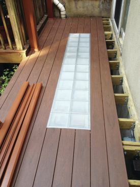

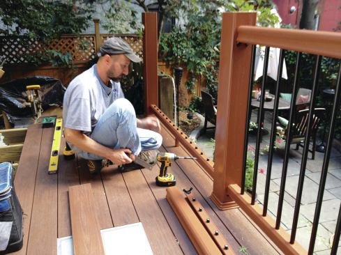

Once the glass panels were fastened in place, we installed the treated rail posts and stair stringers. Then we fastened the grooved TimberTech XLM decking (timbertech.com) to the joists with the manufacturer’s hidden fasteners—though it was a new system for us, it was easy to install.
As occasional deck builders, we liked the one-stop shopping approach that allowed us to finish the deck with one company’s products. We covered structural components with TimberTech’s coordinated accessories, built the railing with the company’s RadianceRail kit, and installed its DeckLites LED riser lights.

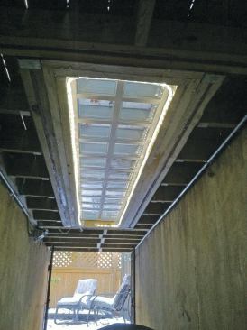

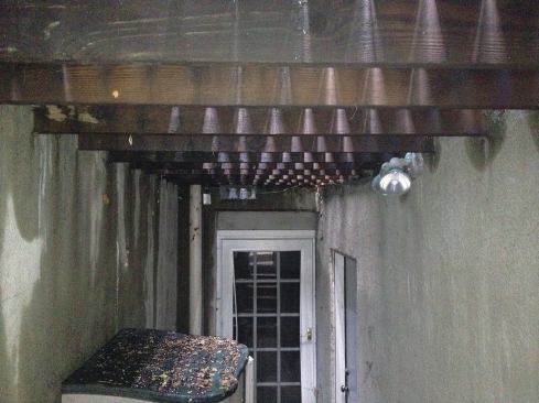

When I visited our client recently on a snowy January day, I noticed that she had added a simple LED rope light to the underside of the skylight (Figure 8).She was pleased with the way the new deck dresses up her small backyard—and with the way her new skylight brightens up what was once a gloomy access to her basement.
