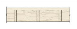

While the decking keeps the top of the joists from rotating, the bottoms are still free to move, at least in the center of the deck where they aren't secured to the ledger or a beam. This is where the mid-span blocking that was suggested previously can play an important role. Full-depth blocking does wonders for resisting joist rotation, and thus limits deflection, regardless of the decking fasteners used (Figure 3).
Figure 3. Installation of a row of blocking at the midspan of the joists restrains both the top and the bottom edge of the joist from rotating. Even half blocks that are held to the bottom of the joists do an excellent job of resisting deflection, as the top edge is restrained by the decking fasteners.
