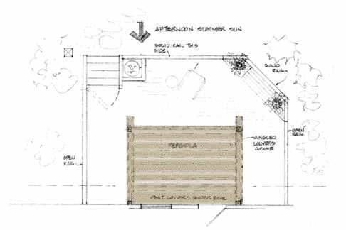

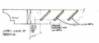

Sun and Shade
If the solar orientation of the deck is to the south or west, the summer sun glaring down all day is likely to overpower an awning or table umbrella. A simple pergola or trellis can provide comforting shade without feeling confining.

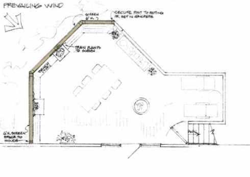

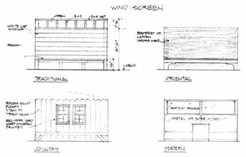

Keeping Wind at Bay
In some areas, prevailing winds prevent enjoyment outdoors — and are especially uncomfortable if it’s cool outside. Wind screens or low walls strategically placed can block the chill wind and keep the pages of your customer’s book from flapping.

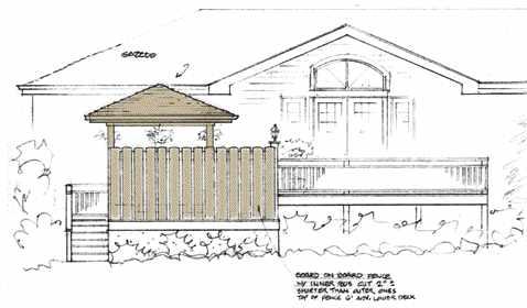

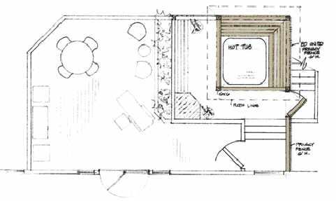

Well-Placed Fencing
Privacy can be a big concern if a deck is to be located close to the neighbors, or on a corner lot where traffic passes nearby. In these cases, screens or walls and structures for plants to climb on, or perhaps a combination, can afford a sense of privacy.
